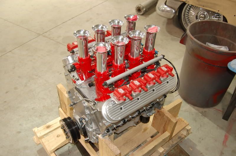

We made brackets to attach to the custom nasty performance valve covers. It requires custom plug wires but also kind hides the injector harness and Idle air circuit plumbing. I like them
http://i56.photobucket.com/albums/g1...1-27-07011.jpg

I like that.
