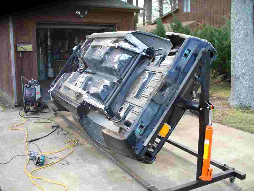

Made a little progress over the weekend, thought I would share with you guys. Got the DSE subframe connectors in and welded, most of the floor sheetmetal patched and all the rear end mounting finished up. Hoping for good weather this weekend so I can get some primer on it and start Jigging up for the front subframe.

File didn't attach, here it is

That picture was last Sat, even though it's the beach and it was sunny, it was still 25! not michigan cold though... This time of year the norm is around 45, but last couple of weeks have been cold.

that looks like the airbar rear crossmember under there.........

Sorry no airbags, homemade mounts for C4 dana 44 with QA1 coilovers. Front clip will be Homemade C4 with C5 Z06 brakes. This is truely a garage built car. No Money, No Shop, No time.... No problem
