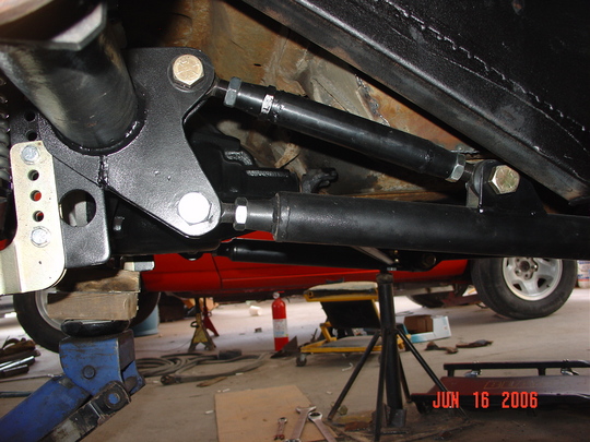

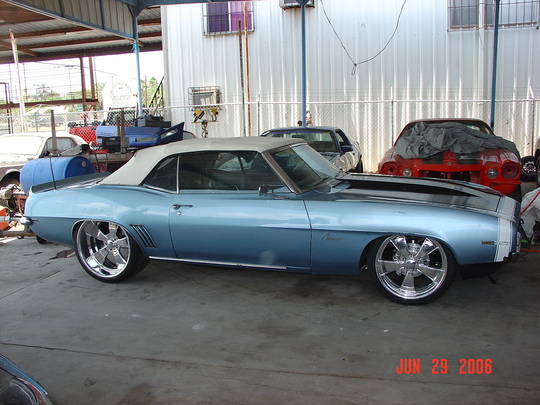

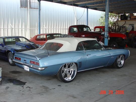

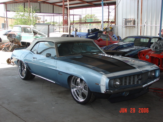

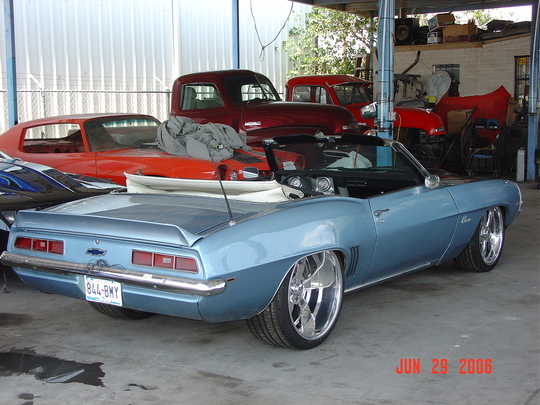

This is 69 conv. i bought this car 1 yr ago all stock. theirs was nothing special about this car so decided to protour it its been out for two weeks know im going to enjoy it all summer then tearing it down in winter for more up grades.her are some pics enjoy.

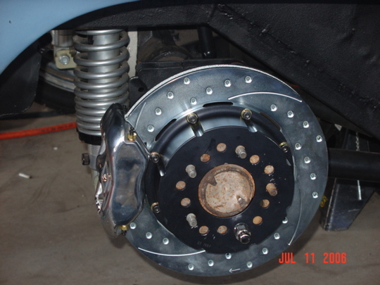

what size are those wheels? Brakes need to be a little bigger in order for it to look right IMHO.

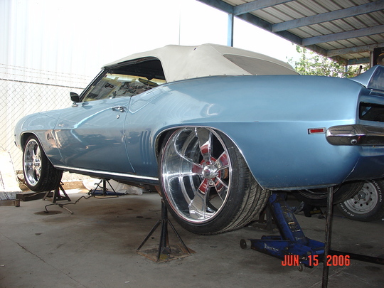

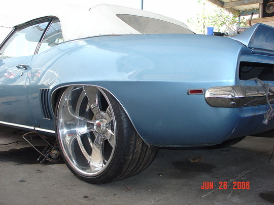

the wheels are 20x9.5 fronts 22x13 rear , the breaks are small im upgrading in winter to bigger ones.

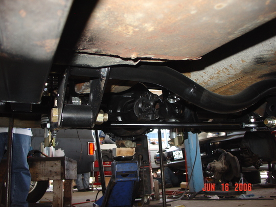

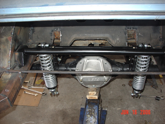

what suspension you running?

thanks, fatman front sub frame with coilovers,custom made rear control arms,and coilovers,mini tubed.

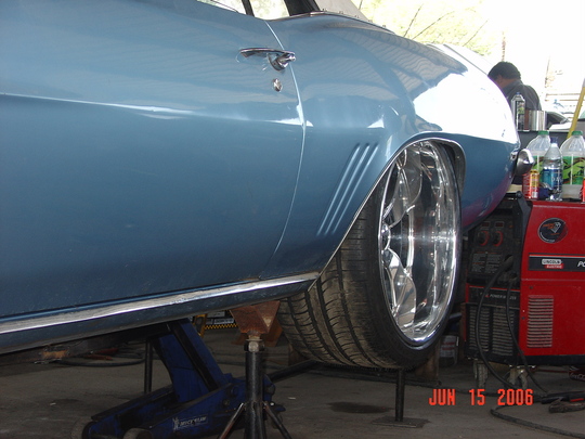

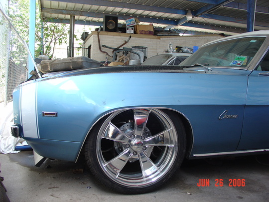

any turning issues upfront with the 20"s? looks good

very miner ,im going to roll the lip on the fender, and fab some turn stops,thanks

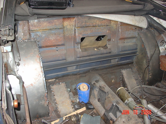

Wow, sweet ride!! Looks like all that fabrication was done right.
