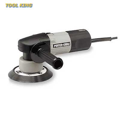

well the Porter Cable has variable electric and I think runs from 2500 to 6000 opm. It's almost 6 lbs, though.

The Porter Cable 7336SP is $120 at Lowe's. How about I go there a Tuesday and the guy says that they are a non-stock item. Then he tells me the advertised price is $42. I told him for that price I'd buy two. He looks at another stores iventroy and guess what: They have 2. I had them shipped to the store I was at. Hopefully they are in today.
