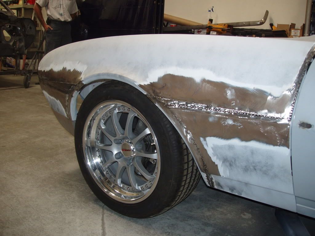

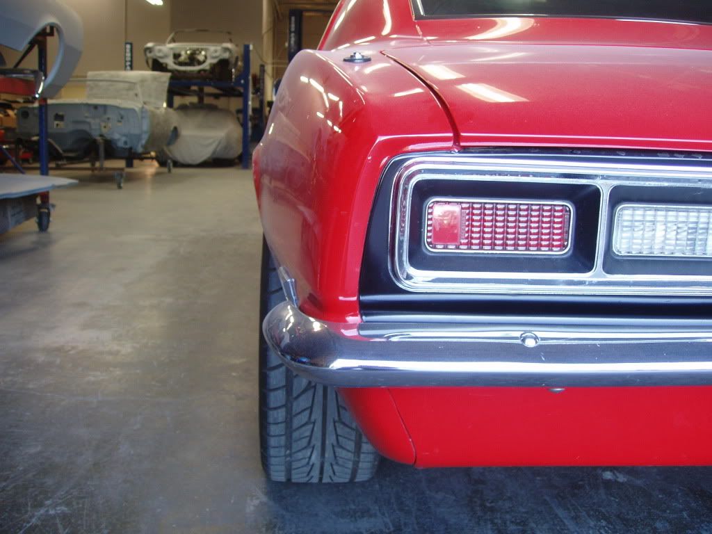

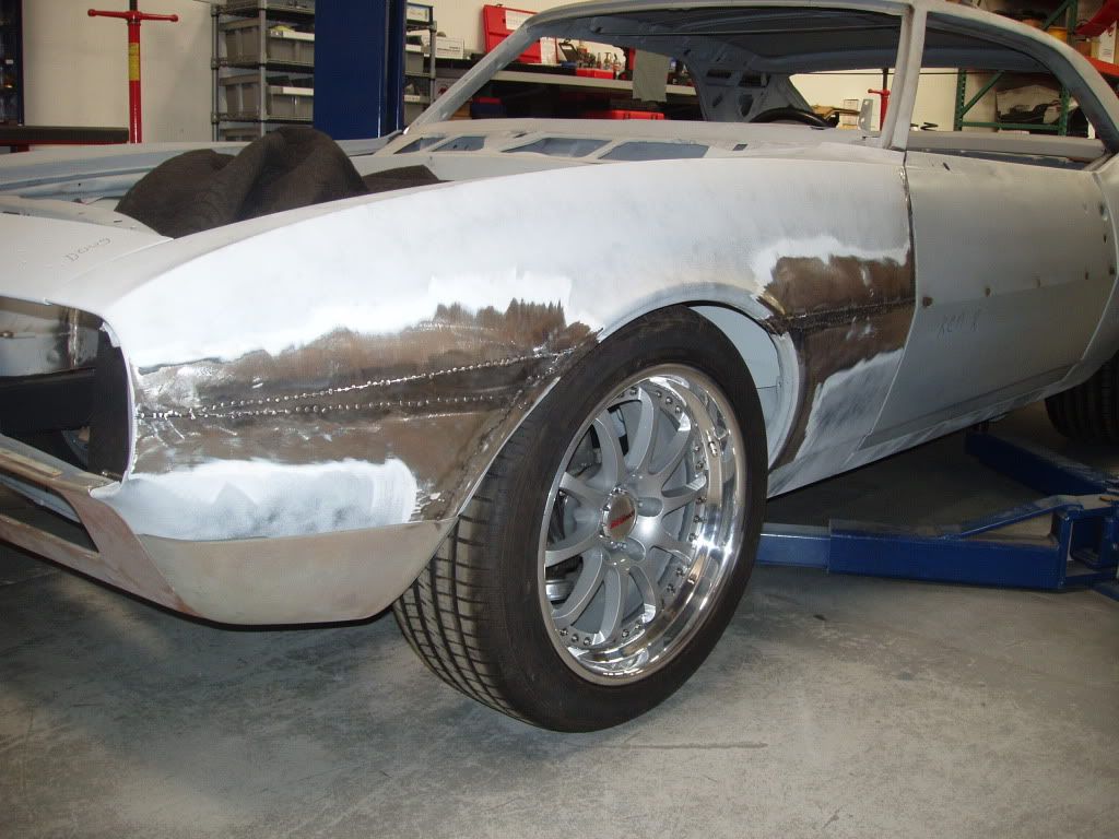

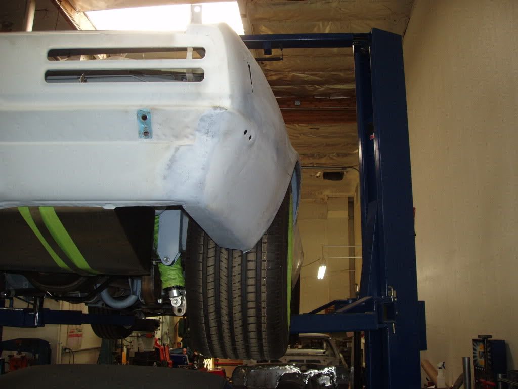

Default Front Fenders
Here are some pics of some front fenders we pulled to gain front tire clearance.. 67 & 69 Camaros have a tapper towards the rear of the car & towards the front.. You will also see that I have a pic of cutting & pulling of the rear section only of the rear of the qtr to have a nice straight look from tire to wheel opening also attached is what the rear view on a stock Camaro..
I agree that front fenders need to pulled so that the car maintains some even porportions on the body lines.. I have had only one request for front fenders.. Track Rat! The car will look pretty damm cool
