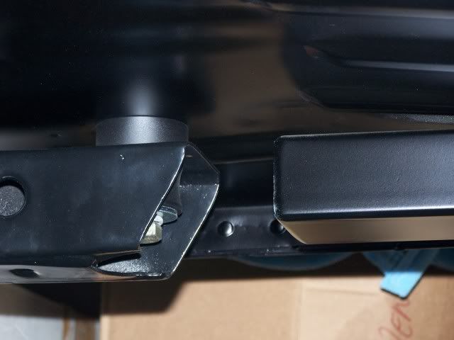

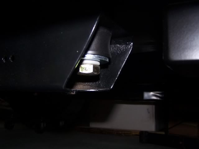

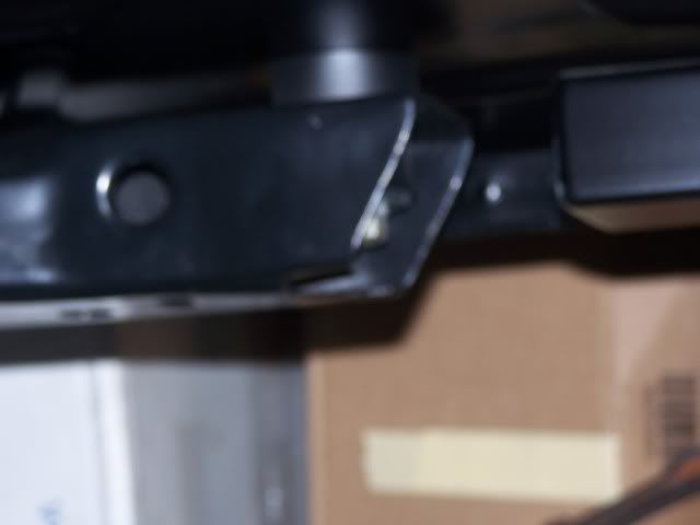

  #454
Old 09-13-2011, 12:55 PM
You guys remember Those nice DSE subframe connectors that were put in my car How fr**kin well do you think they will work without these attached!
Do you believe this!
Floor all painted sub frame powdercoated and I get this.
NOW WHAT

Weld 'em in and paint 'em with POR 15 --- they make a flat black.
Unless of course - you're building a show car. That would be different.
Don't ya just love some of these "PRO" shops?!

Those are the Sub-Frame ALMOST connectors! Don't let it get to you Wayne. Don't they bolt to the sub? Weld them in and touch up the paint. Like Greg said, which one are you building? If you want perfect, you know what you need to do. Not to get you down, but building these things are like that. They don't call it custom for nothing! I know it hurts when you pay for mistakes. Ask Greg and I how we know! Hang in Buddy!

Hey Wayne - I know it bugs you, but at least you know it is the order of things. Ever since I put my plan together and really thought it through, I was questioning how the heck you pcoat/weld/finish color on these things. I even did a reality check w Frank. So when I went to pick up my car, we had to grind down the pcoat at a clean line, weld'em up, and then shoot raptor over it. We did it same day I loaded my car in the truck! So really the only thing I don't blame you for is being upset about Mikey not gettimg that done prior to departure. Just one more thing to add to the list of gripes w that guy.....

I'm sure it stings a bit. Is the car all put together and is all the body work done on the doors and front end. It could be that he didn't weld them in yet cause the subframe is properly aligned yet. There is no way to weld those in and not have to touch up either the paint or the Powder coating. You would of had to have those welded onto both the subframe and connectors, then the bottom and sub would of had to been painted together.
Since the sub frame is powder coated it would of needed to been touched up afterwards anyway. Just add it to the list of stuff that he didn't do.
