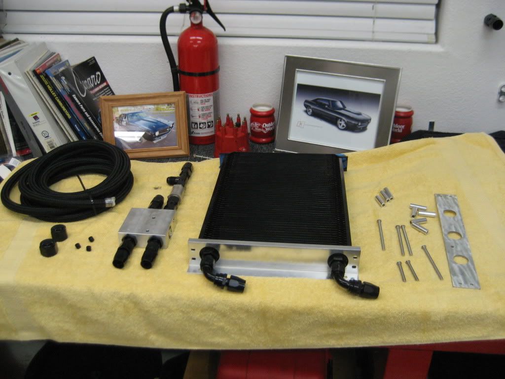

Back to the fastest black 69 Camaro on the planet. I'm trying to stuff a full size truck in a compact spot. If you read my thread, you know that my oil temps were getting a little toasty at buttonwillow. Since I have to plumb in a larger oil cooler, why not over engineer it right? Honestly, my thought is that it will help keep the engine cooler in these brutal Summers as well. I may install a fan later below the grill opening to aid in high heat conditions. Also, I'm switching over to a full synthetic red line oil. My engine builder, Jason Pettis, said go for it and he wasn't concerned with my oil temps for that short duration. Clearly, they must come down and synthetic oil will take the heat better and keep it's viscosity. I was running a partial synthetic Brad Penn.
As usual, this project got expensive. Between the fittings, hose, oil cooler, t stat, it wasn't bad. Then I decided I needed to upgrade the shop for the project. Nothing to spendy but I picked up a new drill press and belt sander so I can fabricate with more authority. Car's 99.9% done, perfect timing!
I fabricated the mounting bracket and lets just say when I mounted it, it didn't work out quite like I had hoped. So now, I designed a bracket for my water jet guy and I can still use my bracket, just not how I imagined.
This engine has 3k? and a boat load of races on it. Maybe 15? Anyway, after Buttonwillow I found my oil sender had come loose and was touching my Z bar. It happened while at Buttonwillow since I just had the trans out for the synchro upgrade. Moral of the story, I found a trick extender/or block fitting and I'm taking a few pieces out of the equation. Luckily, it didn't leak or that could've been a bad deal! It's a super tight area to deal with.
