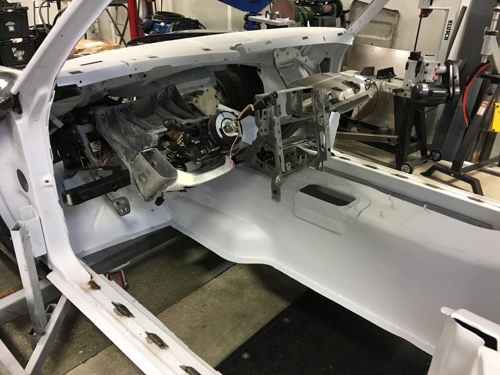

I got back to work on the car on Saturday. It really sucks now only being able to work on the car every other Saturday since I can't keep it at work anymore. So to check some clearances I put the block and supercharger in. The supercharger needs to move back about 2", but as you can see its already hitting the firewall.

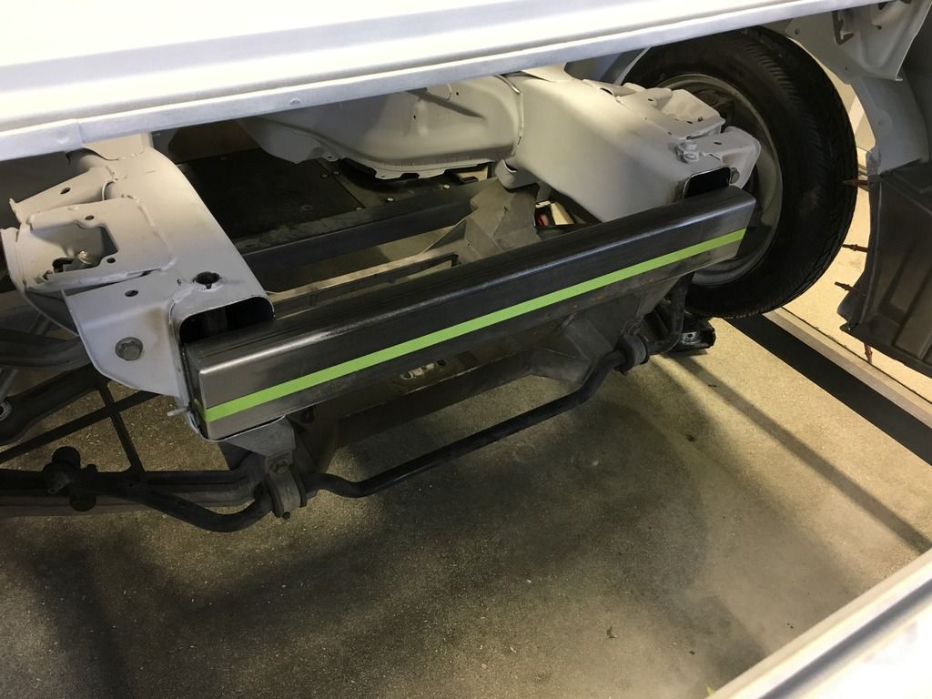

So while I thought about how I want to handle this problem I went ahead and mounted the pedals, brake booster, and column along with the stock C5 dash frame work to get an idea of what kind of dash I can run. Now with two road blocks in my way I turned to the rear frame so that I can get the rear body mounted to the frame so it can come off the jig. I decided to tie the frame rails together since I cut off a large chunk of frame and marked it to where the floor height needs to be. I'm ordering some 2x4 frame rails bent 90 degrees the hard way so I can run jogs out to where the factory first gen Camaro frame rails mounted to the body. I think that about covers it for this go around of updates, on to the pictures.

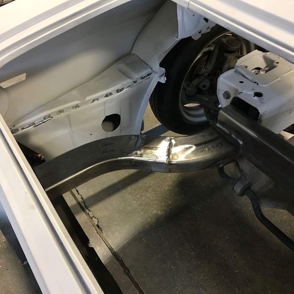

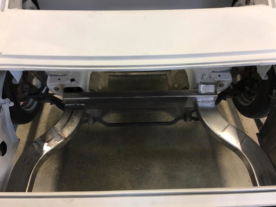

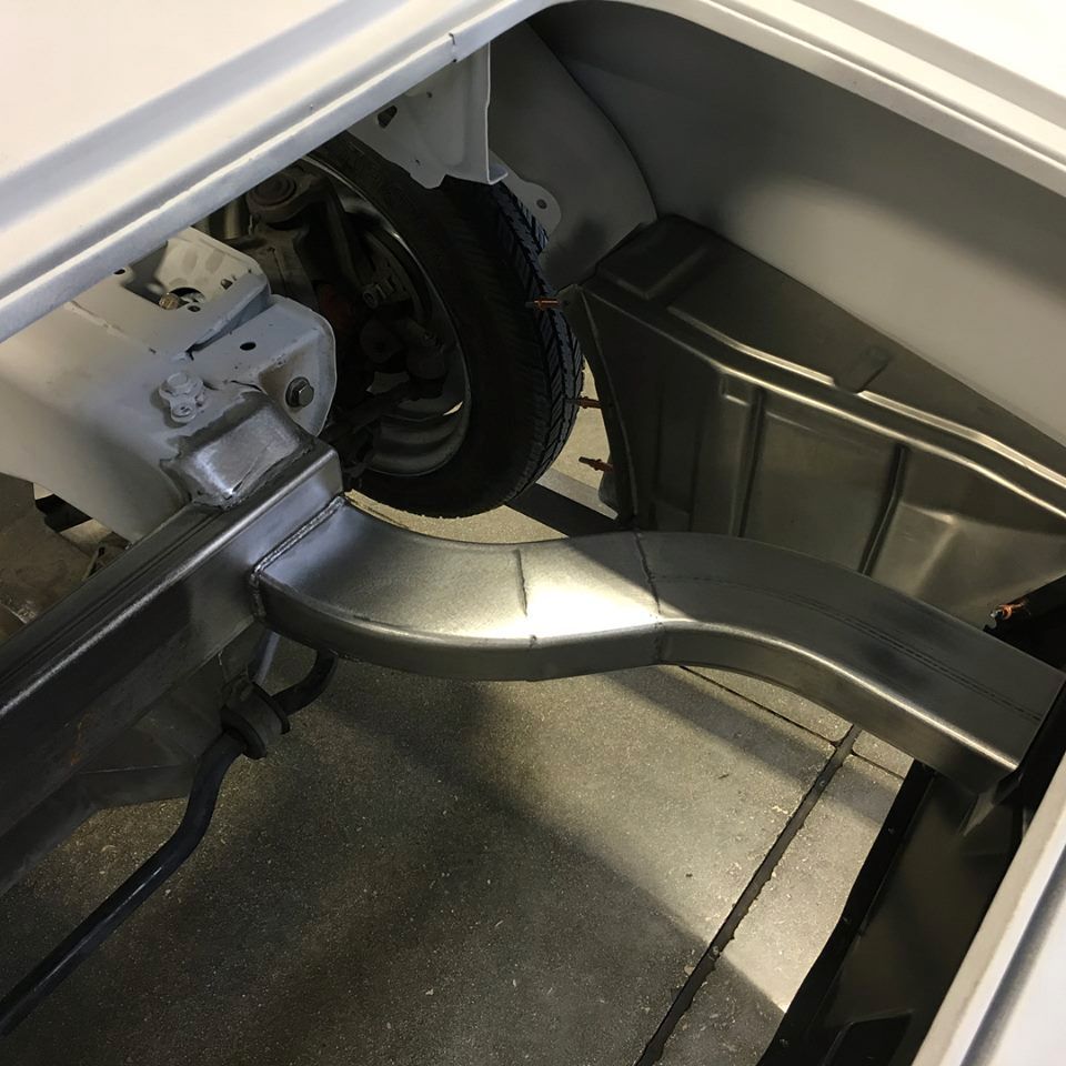

Saturday I was able to get a good start on my frame to body rails. I wanted to run the rails to the stock Camaro location and ended up with these. I started with two 90* hard way 2x4" pieces of tubing from Art Morrison. I ran out of time to get the driver side done so that will have to be another day. The passenger side is gusseted on the bottom to tie the cross rail, Corvette frame and the new rails all together.

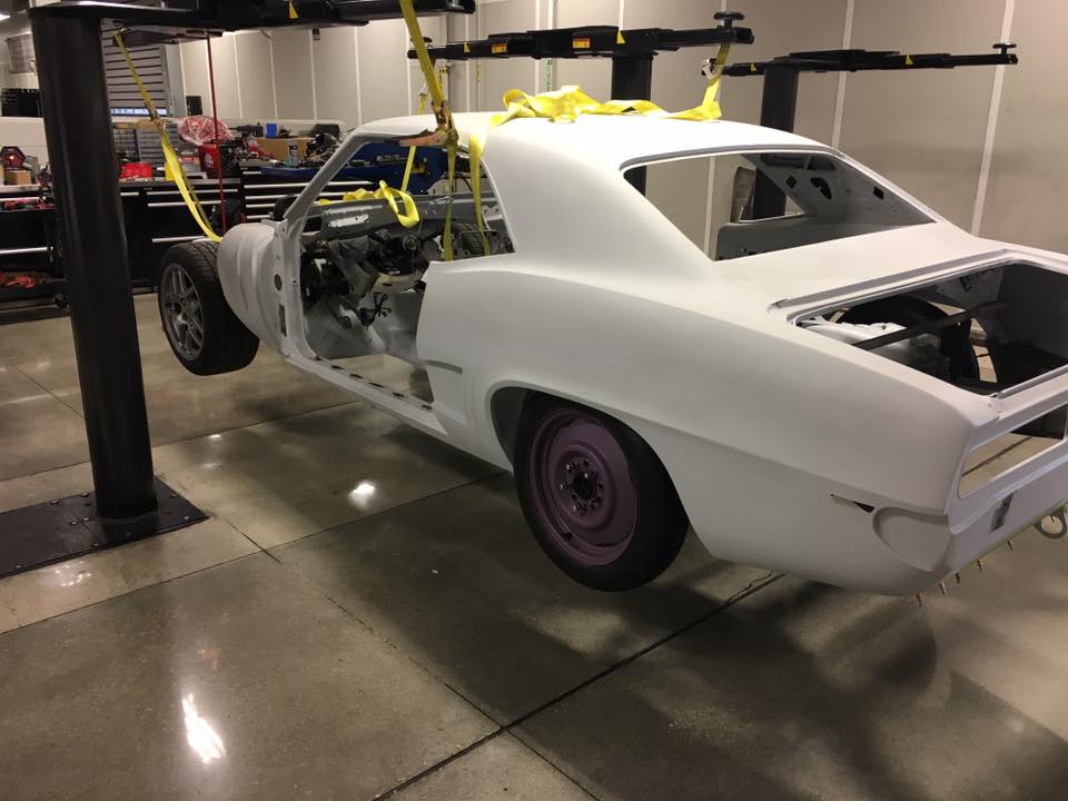

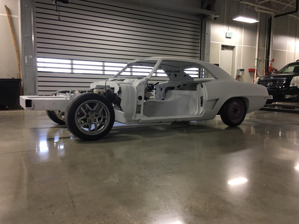

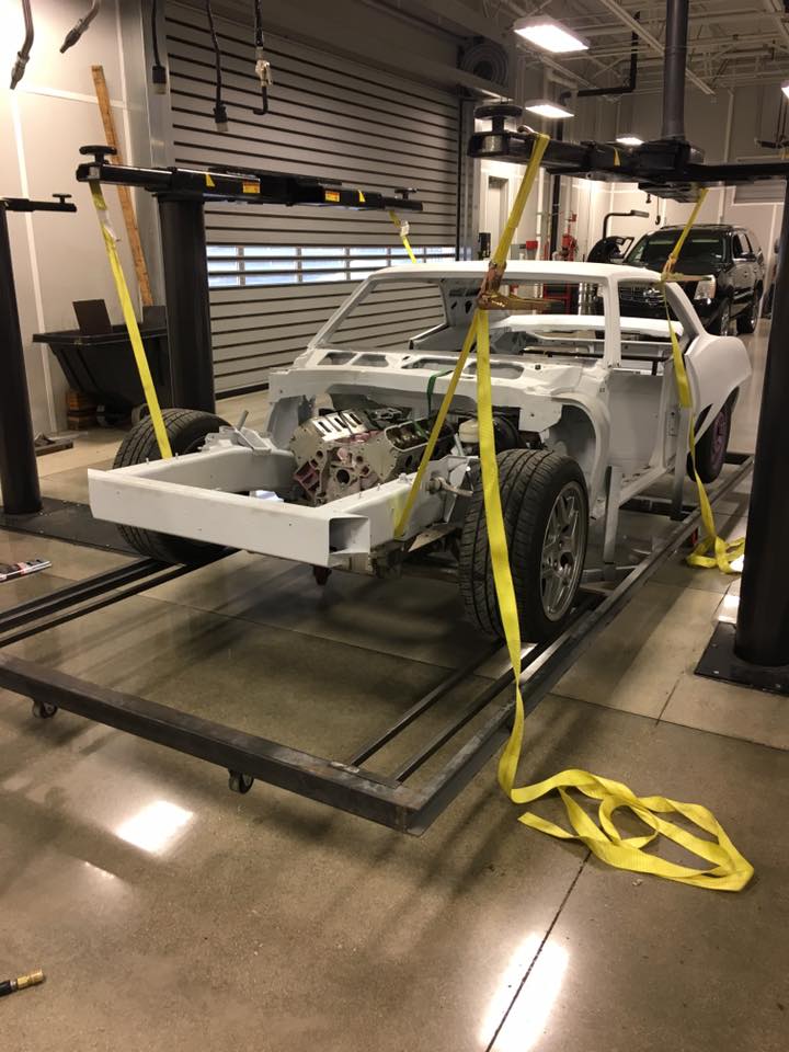

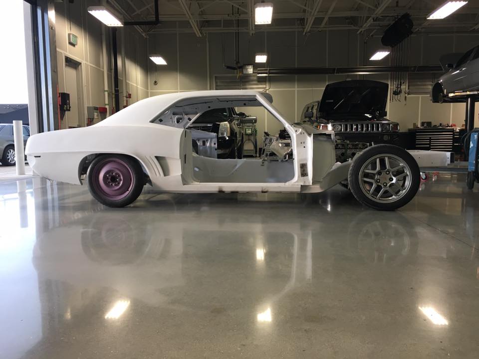

Well I lost my shop space to be able to work on my car so I don't know when I'll be able to find somewhere to work on it or where. Maybe someday the car will get done. I went ahead and finished welding the frame rails to the body and supporting the trunk supports so I could take the car off the frame rack to get more room in my trailer. It looks pretty good on the ground, this is the first time its been on its on feet with this configuration. rocker height currently is 5 3/4".

It does look great on the ground - once you get past the wheels!
