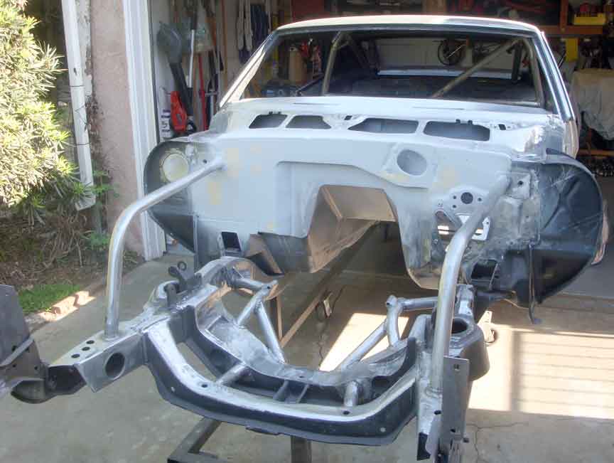

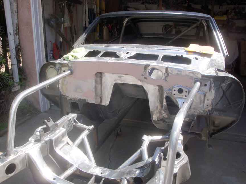

I did more sanding today with these 3m bristle brushes that attach to my grinder. wow, they make easy work on the sheet metal, and without much heating, too. Good stuff. They do get chewed up on the edges, though.
I also spent some time trying to shrink the warpage out of my filled firewall. It was a wasted effort, I was just making things worse so I cut it out and made a new panel. I also filled in the old blower motor hole.

Firewall came out nice. I just saw the picture of all the sheet metal on , it looks nice all back together ( Even if it was only on for a little while ) It all looks nice and tight.

Awesome firewall!! Your fabrication skills are a inspiration! Do you have any more photos or tips on the on the firewal... like a "how I did it" on the firewall?

Thanks, Jarrod! To answer your question- check out an earlier post I made on the firewall:
https://lateral-g.net/forums/show...3&postcount=73
It shows the first patch panel I made and the recessed area. I had since warped it so I cut it out and replaced it. Let me know if you need any more specific info on it

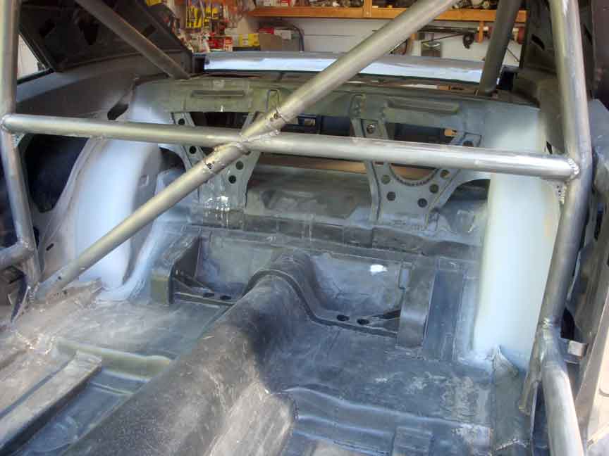

The pics in this week's post prove that I'm not there yet. I had to get the bondo out- to fill in the dips and voids in a few key areas on the visible areas inside the engine bay and interior.
