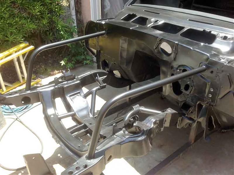

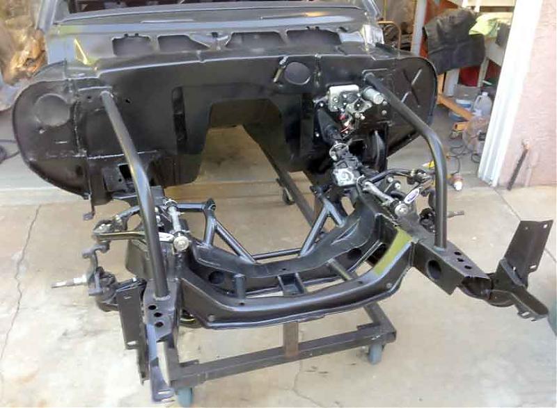

I am a little bit suprised that with all the work you put into the cage you didn't add a door bar that would run from the main hoop and run under your armpit. I'm laying out a cage that is almost exactly like yours and so far it doesn't seem to hinder seat entry/exit.
Thank you. The reason I didn't build the cage closer to me is I intend to also drive the car on the street. As such I don't want to have to wear a helmet and 5 point harness every time I drive. That's why the main hoop is further back than usual. The bar parallel to the rocker panel is tightly tucked under the arm rest- allowing that to provide some cushion between it and me. I know it won't pass NHRA spec...

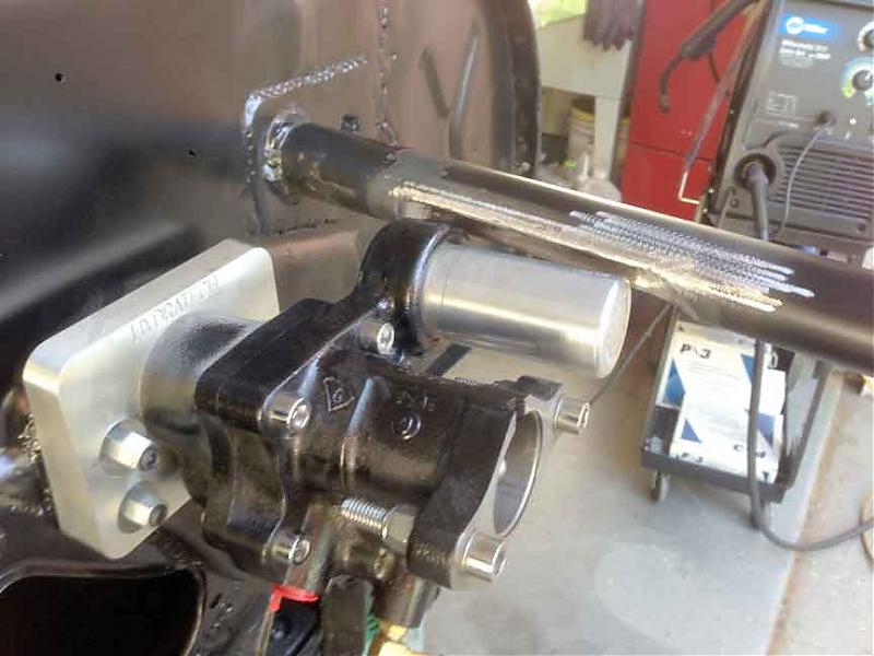

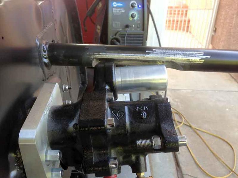

Default Measure three times, and once more to be sure.

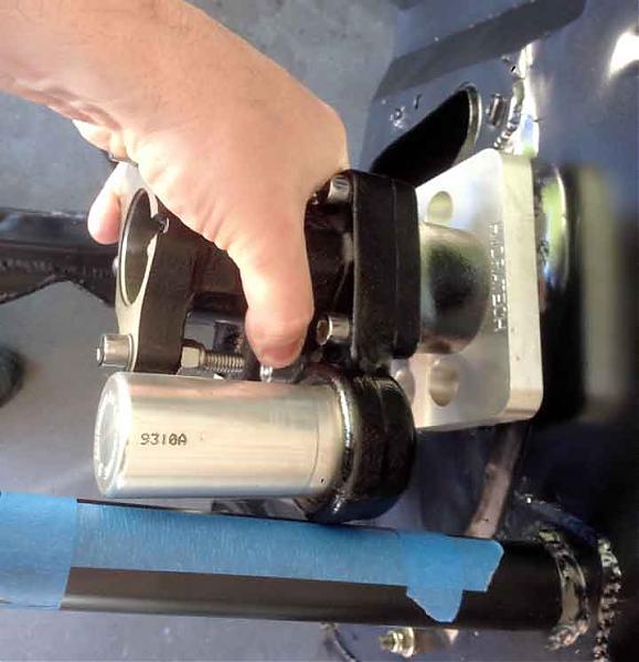

OK, a month later and I'm finally back in the garage for a little bit- only to discover that somehow I botched my fabrication while building my car. I swear I mocked this up, but when I went to fit my hydroboost unit to the firewall it wouldn't fit. It interfered with the hoop support tube in my engine bay. d'oh! So the cut off wheel came out and I spent most of my time notching the tube to make enough clearance. Now I'm concerned that when I install a master cylinder it will interfere with my inner fender. I just know it will...

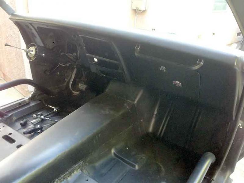

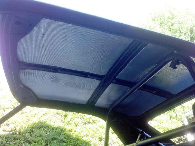

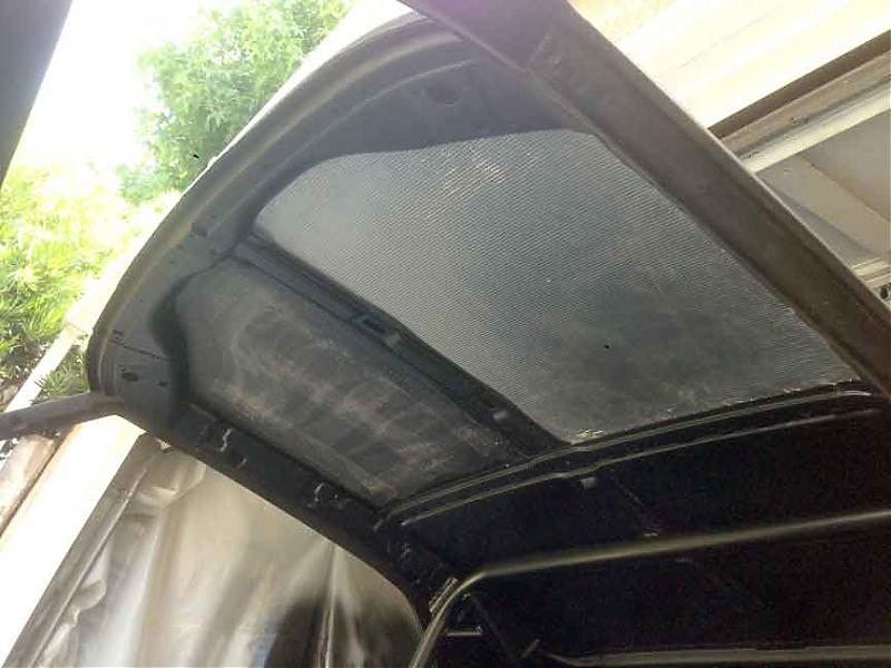

After notching the tube I painted it again, and a few more parts today, as well as some foam insulation on mt roof.

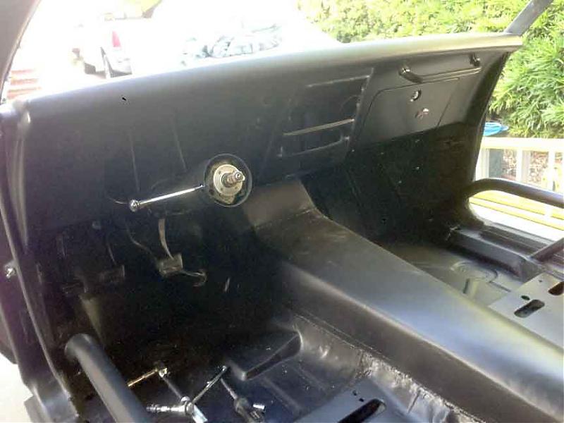

Also, in my haste- I've installed my kick panels and e-brake (remembering those go in early), but now I'm thinking they need to come back out as I didn't install the door jam switches for the dome light. While it may be possible to install those, it'll be a lot easier to fish the wire where I want it with them out. So out they'll come again :p

Speaking of which, I was able to get a little assembly done yesterday. Those door jamb switches are non stop hassles. After first buying a set from local parts stores (and traveling to 4 different ones to locate two switches) I brought them home to discover they didn't even fit. So then I ordered a set from Classic Industries, and installed those this weekend, which did fit. Then I found my originals, and they are shorter in length than the ones from CI. Considering they are original to the car, I know they work. I'm now concerned these other ones will be too long, so I'll need to take them out yet again

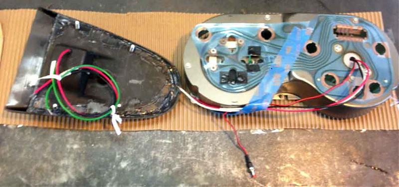

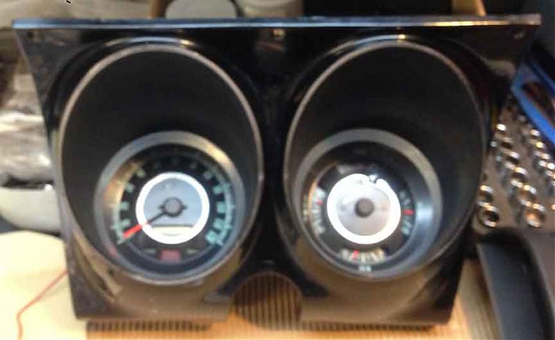

Ok, my gauges came back in from Redline gauge works today. I'm stoked. So I put them back in the IP.
I kept the gauge faces stock, as I like them, and they were in fine shape. Redline updated them mechanically- it now has the digital speedo, updated tach, and volt meter. I also painted the back lit areas orange/ red as I don't care for the old GM green lit color. I much prefer more modern red as seen in newer Trans Ams.

Sweet gauges!
  #300
Old 06-27-2013, 06:30 PM
The pictures look nice and the gauges look great . They do nice work at Red Line. I'm hoping to send mine there.
