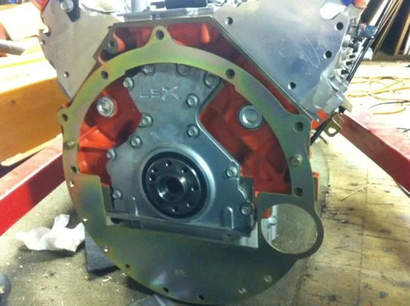

Transmission:
I order all my parts needed from american powertrain. All I can say is that if you are looking for anything transmission or transmission related they are the place to go to. Those guys over there have seriously bent over backwards to get me my stuff and keep me happy. Josh your the man. I recieved all my parts from them on wednesday and was waiting on the bellhousing to come on thursday. Somewhere along the line my crossmember ripped through the box and was not there when I opened the boxes. I was also upset that the instructions and the white lightening shifter was not in the boxes. I decided to call their 24-hour hotline as it was after business hours. John the person I have been dealing with answers so I am pretty upset at this point being that I was excited to intall this stuff. He emailed me a copy of the instuctions while I was on the phone..and tells me he will send out a crossmember and my shifter tommorrow for 1 day delivery at no additional cost to me. Talk about service. Then last night I had some questions about the install and I called him. He was on the phone with me for over 20 minutes taking me through the steps. I can not even begin to tell you how helpful he is when it comes to this stuff. He truely has put the customer first in every single way. Big thanks to him and the guys over there. It has been my pleasure. Heres is there contact info.. 931-646-4836 x107. With Josh's help I installed the flywheel, pilot bearing, clutch, pressure plate and bellhousing last night. My dad and I will be wrapping up the rest of the install on this weekend so more to come.

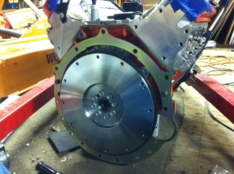

So it has been a long last couple of days. Many hours spent cursing, laughing, reading directions, and on the phone with Josh and Gray at American powertrain. Can’t say enough about them and the after hour hotline. Has been a huge help for me all around. Both those guys are A++++. So we received the shim for the hydromax clutch assembly and the narrowed rear/axels from Moser on Tuesday. Got over there after work to put the transmission together and also assemble the rear so that is can be a roller again. Starting on the rear and realize that the axle seals are not there...stopped that for the night.
Ok..on to the transmission. Excited to finally put it all together. Measure for the shims again..and throw the shims on and bolt it all together, place it in the car. Talked to Gray and figured out the crossmember, realized that we are missing the offset plate. He tells me he will over night it tomorrow for delivery on Thursday. Later Wednesday morning I wake up at 3:30 to give the baby his binky and I remembered that we didnt put the feed line on the clutch assembly. Well that sucks..it has to come back apart. So back over there after work on Wednesday... my dad already started pulling it all out. We finish getting it out. Take it apart, install the feed line, back together, in the car. Not to bad all things considered.
