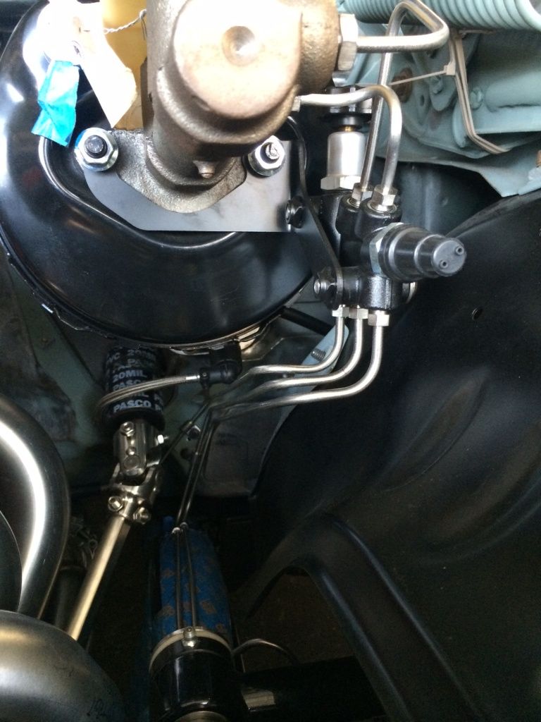

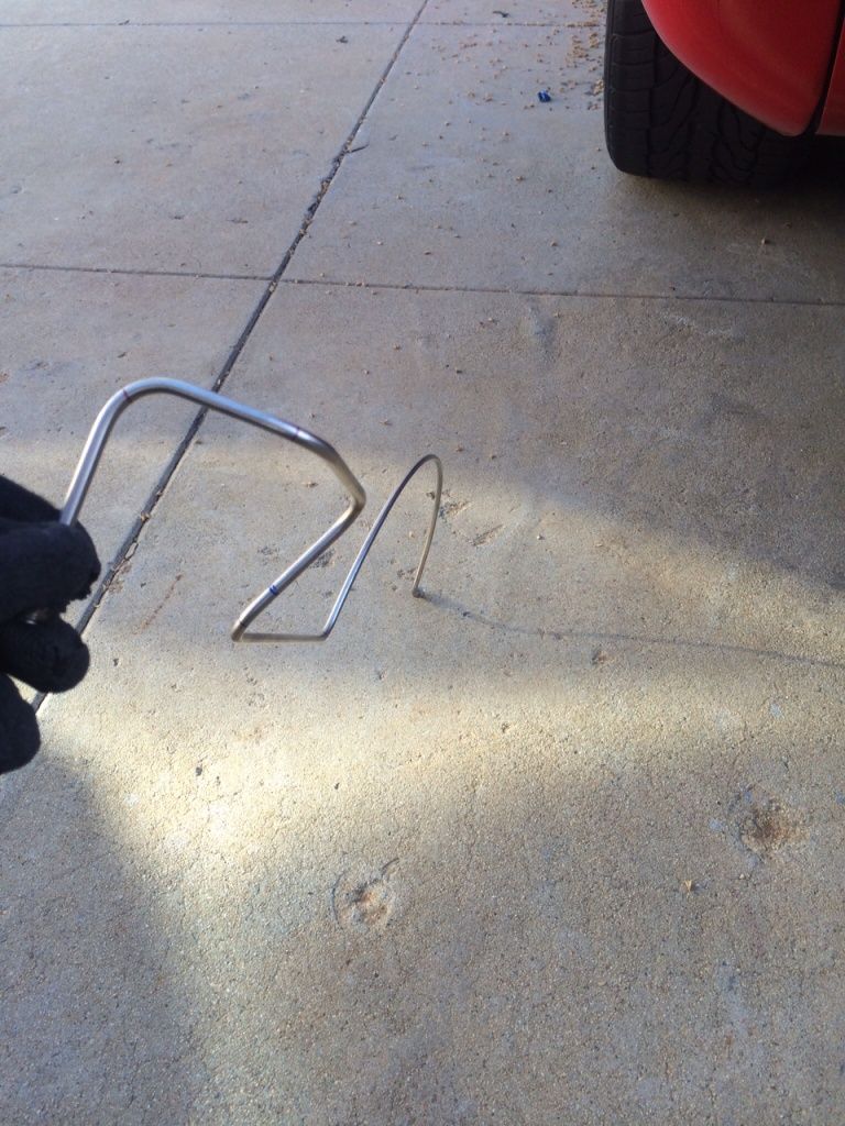

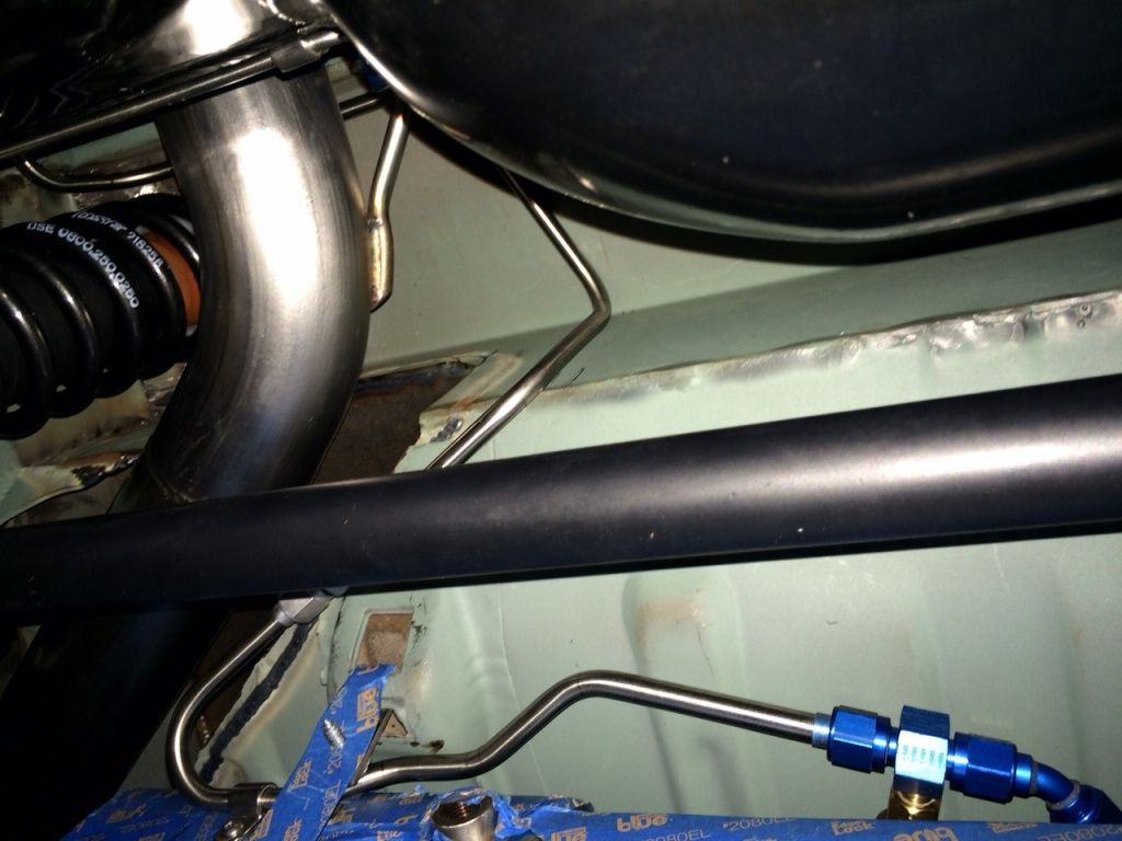

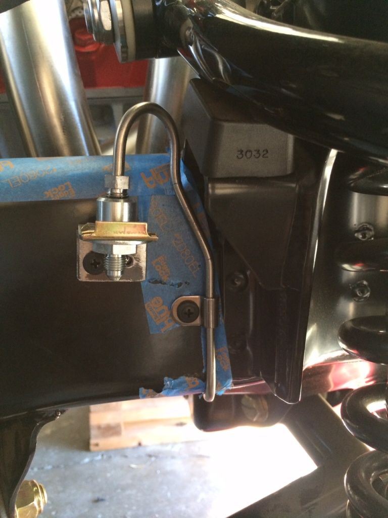

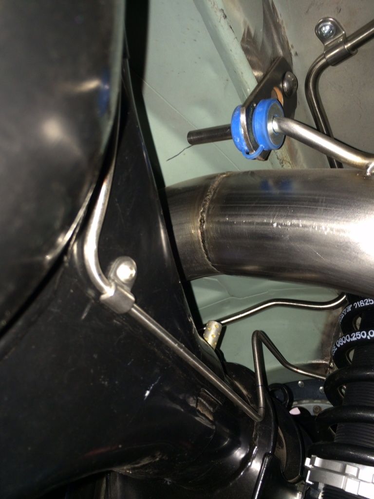

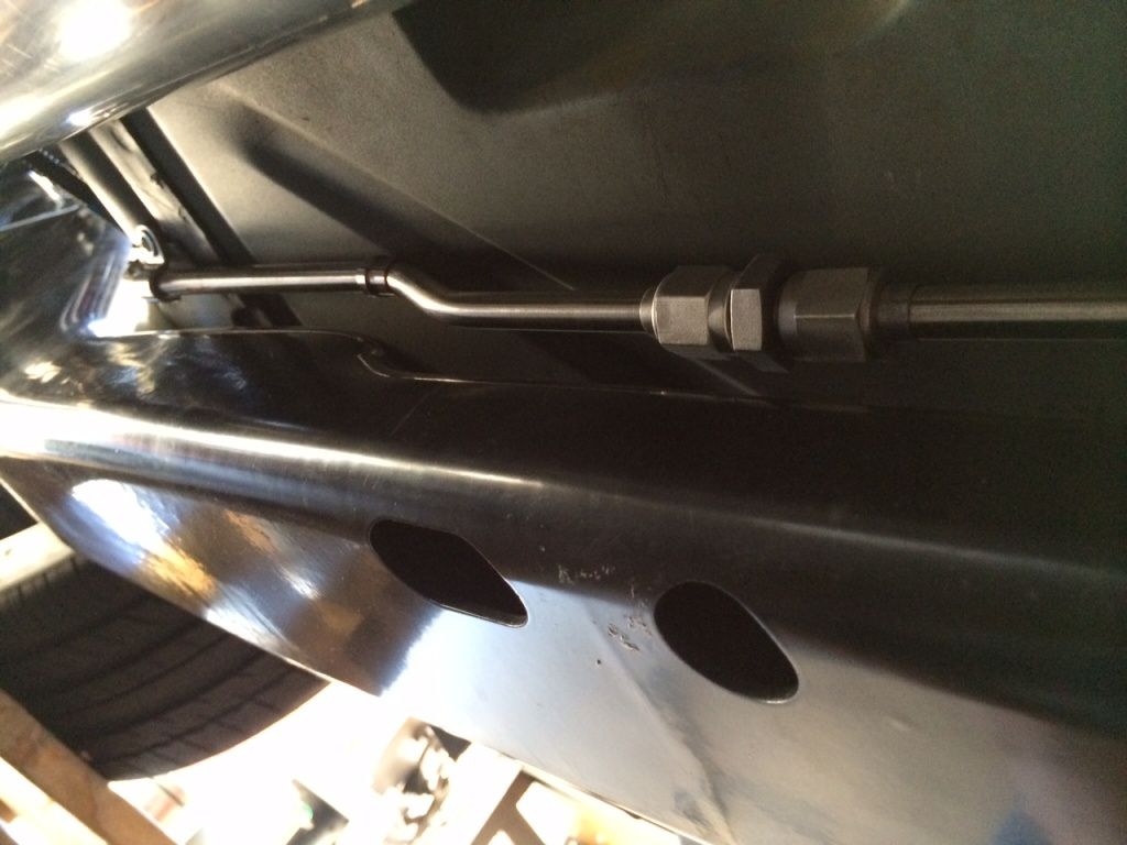

Brake lines are done was able to run one piece from proportioning valve to flex line for fronts. 3/16 SS. Any one looking to buy a flaring tool I will highly recommend the RIGID 458r for 45s and they also have a 37 degrees. That's the best tool I have bought and here benders same quality.
Fuel plumbing is also checked off the list 3/8 SS.
I ran both fuel and brake-lines on the inner side if rail "hope it don't get to hot"" maybe build a heat shield.
Rear end passenger side piece
Front passenger

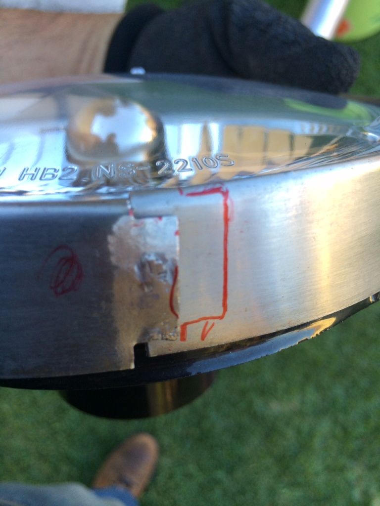

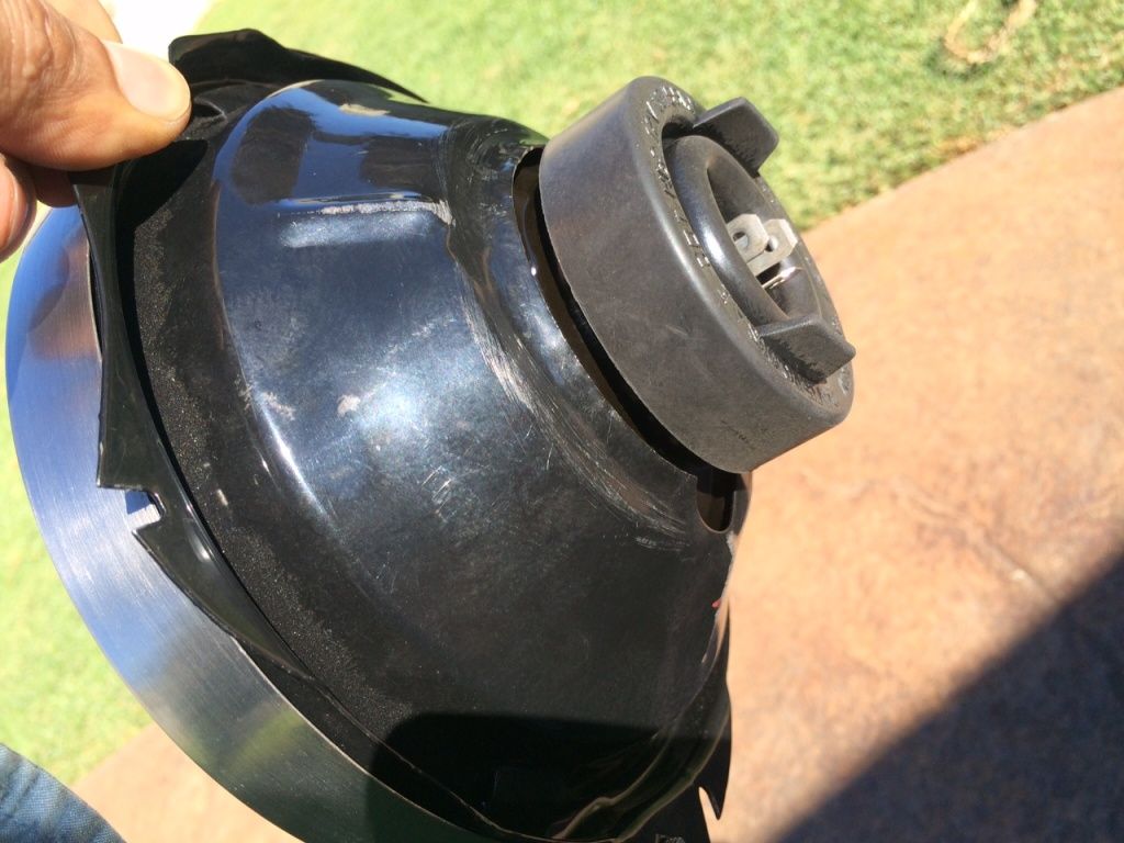

Cut rings to make them fit like I want them " tight"
Cut and flared out the buckets

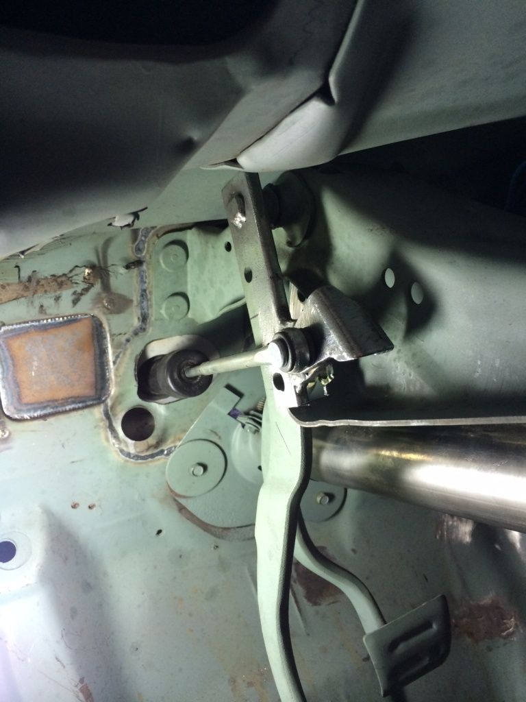

Setting up clutch pedal with a stop and pushed pedal 1/4" towards passenger
