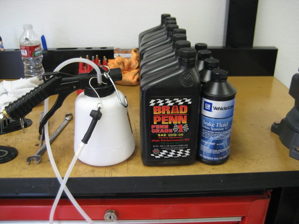

After about 4 hours of elbow grease, I finally have most of the rain washed off this baby top and bottom. It was worth it! I've got my first SCCA race coming up next Sunday. Rumor has it that we have been bumped from our normal lot to the best lot at Las Vegas motor speedway. The SCCA guys said they have only had the priviledge to run there once in 10 years. High speed and 70-80 second runs. I can't wait!

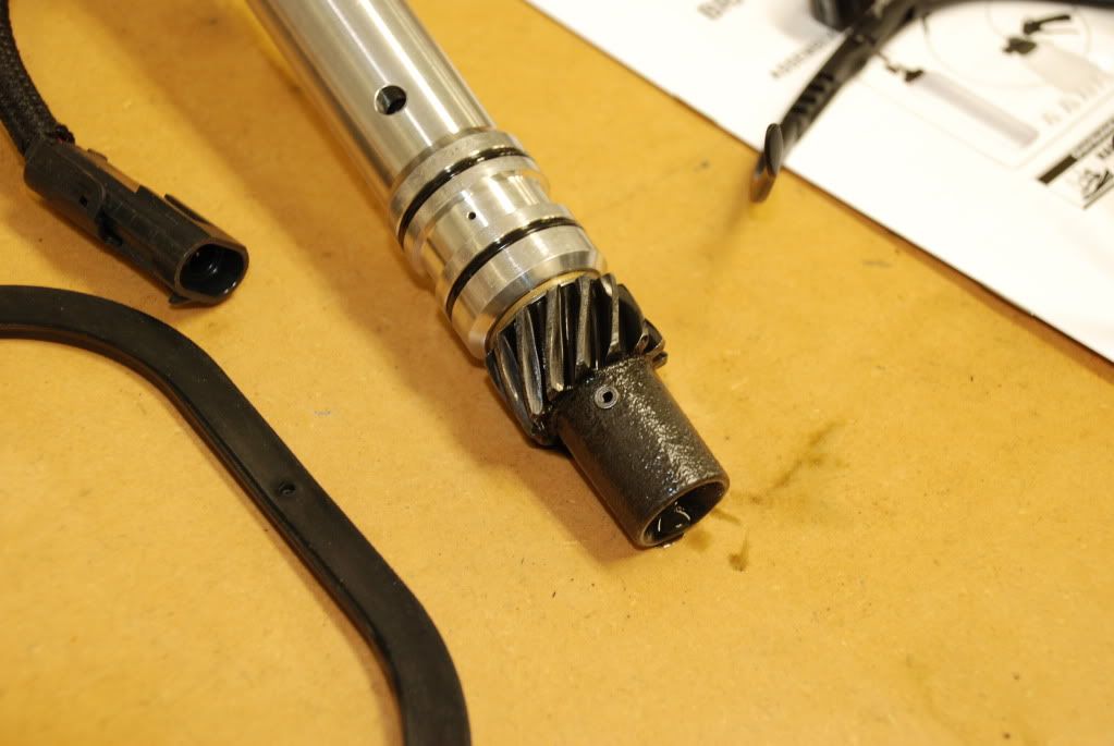

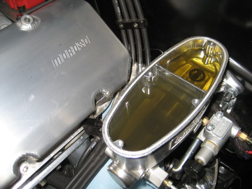

These cars are definitely high maintenence when you use them at their limit. Of course having an all aluminum solid roller big block doesn't help. I haven't changed the oil since September so that was first. I always cut the filter open to anticipate any problems. Everything looked fine. It takes approx 12 qts between the engine and accumulator. I checked all the valves cold. Spec is .006 cold at .016 hot. Found only a few that were out of spec. One at .007, two at .008, and the loosest at .010. I pulled the distributor to check the gear. It needs replaced. The engine has 2500 miles or so and around 8 events so it was due for an inspection. Glad the oil filter bypass is blocked and I run a magnetic drain plug. I have another melonized gear on the way. Looks like I'll be replacing it every 2500 miles.(Every year)
After reflecting on the road race Sunday afternoon, I realized that my brakes felt spongy. Once I got the car home and pulled it off the trailer, they indeed felt really spongy pulling it into the garage. After a brake fluid inspection. The front resorvoir fluid is thrashed. The front rotors have been pretty hot. I'm going to lean towards overheating at this point with moisture a close 2nd. Anyway, I picked up a power bleeder at harbor freight for $25. I flushed the rears and fronts with genuine GM brake fluid. I'm going to give it a shot. It took two pints to clean up the front! I suspect my back to back to back to back to back runs on the 0-90-0 event are to blame here.

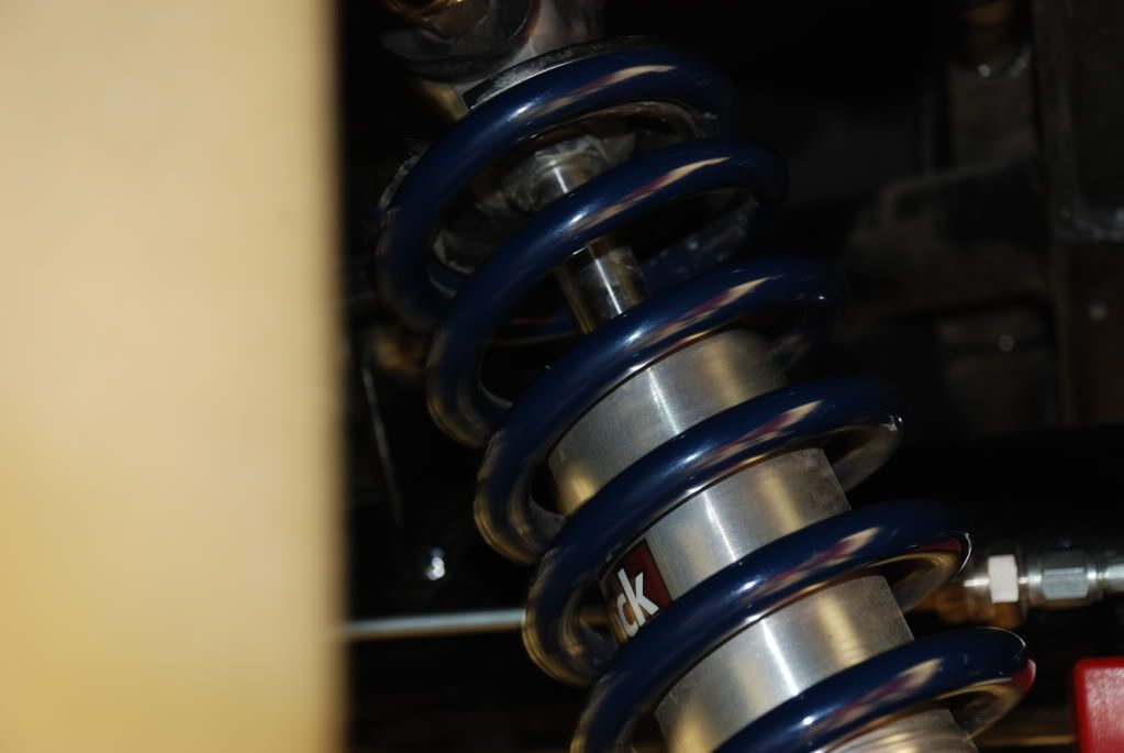

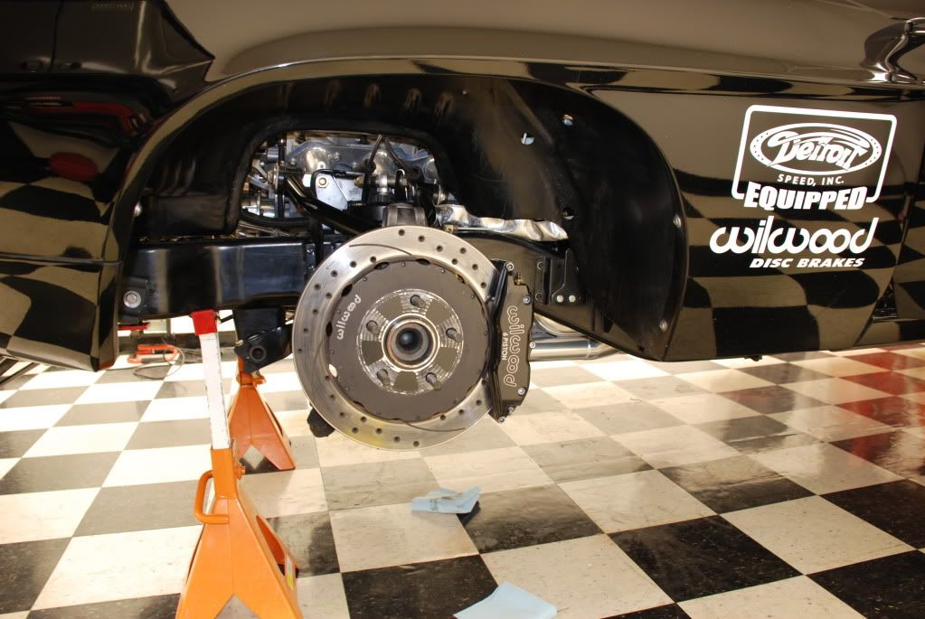

For those of you that have been following along, I made new rear shock brackets to give me an additional .5" of compression travel. I found that the car was bottoming out the rear shocks big time after the Optimat Street Car Invitational.(Since day one really) I raised the spring rate 100lbs as well. I took the car on 2 desert hail marys and ran the El Toro event. The RR always compresses about 3/16" more that the LR. Upon inspection, I have a good 1/4" of travel left.

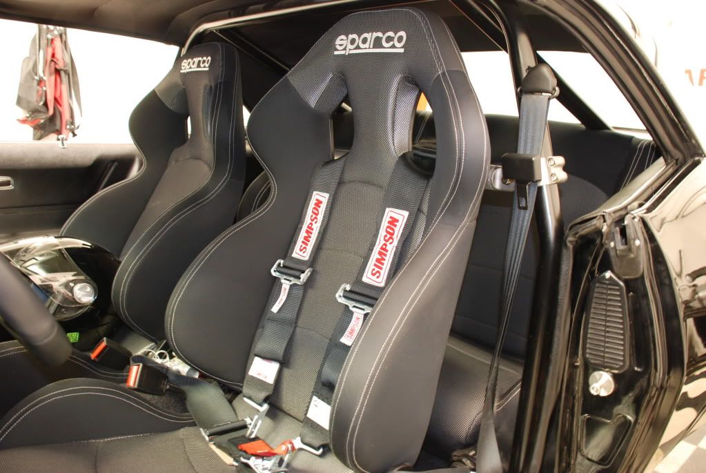

I took the race belts to RTTC but was to busy and lazy to install them before the event. I finally got around to installing them last night. I opted for a set of Simpson old school harnesses. They are reasonably priced and this set up worked out perfect. Kelli cought me simulating putting a beat down on Carl, Gordon, or Rupp.
