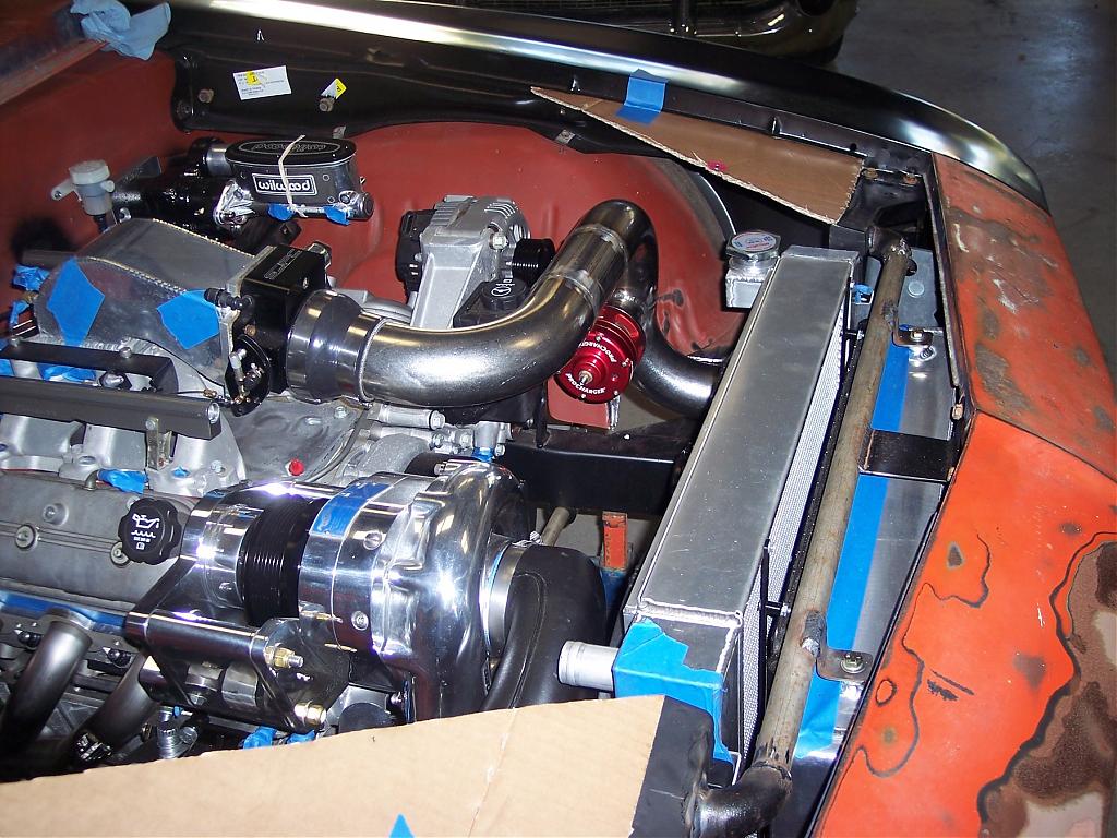

Did you move the core support about an 1"-1 1/2"? Please keep the pics coming? What radiator will you be using? Also, I would love to know the part number for the inlet hat. Very cool build!
Thanks for all of the compliments guys.
The core support is in the same spot, I cut it in half then boxed in the sides to move the radiator out about 3/4" to 1". The radiator came from Frank at Prodigy, I had to move the top hose inlet up and in so the hose would clear the inlet hat, I also had to build a little box and lower the filler neck so it would clear the hood and soon to be filler panel. I will get you the inlet hat part # and a phone# to the place I bought it from. I spent $50 sending inlet hats that wouldn't work back. Also looked into the one that Jay Doerfler is using on his build but I found out he was using the smaller blower. I could have moved the motor back a little further but it still would have still been tight.

Originally Posted by DJW32 View Post
Thanks.
I lied, the radiator is moved 2 3/8" out from the stock location.
The inlet hat came from east coast supercharging 606-752-0321. It is for their Paxton SCT600 2007 to 2008 GM truck kit. You can see a picture of it installed on a truck. The picture shows it to be aluminum, I was told that they only make it in plastic but is is a good quality piece.

Thanks.
Do you know if that is a 4" inlet on that F1?

The inside diameter on the inlet hat for a F-1 is 3.75"
