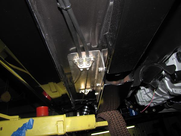

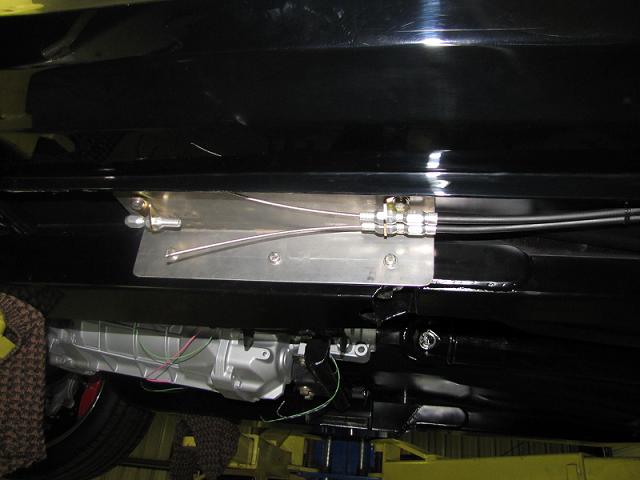

After searching on the forums for a nice clean way to run the emergency cables on a F-body, this is what I came up with. I bent a piece of 19 gauge steel on a brake then used nutserts to attach it to the side of the subframe and floor board, it should be plenty rigid for what it needs to do and it will be painted black also. I am sure there are better ways to do this.
