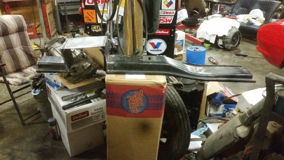

Ended up fabricating a exhaust cutout on the factory crossmember with some 6in wide 3/16th thick plate steel and it's made sideways because the floor is at an angle in that spot.

Maybe later down the road I'll do the next one in a tubular fashion to lose some weight.

Not much stiffness to that box. I would recommend gusseting it in the corners (while still allowing enough clearance for the exhaust). You could also possibly support it on the outside of the box. Either way you need more stiffness if that is really the transmission x-member.

It flexes a little with a 1in gussets on the corners, we'll see what it does with weight on it before I add more supports.

Dropped the engine and trans and the crossmember fit perfectly except for one of the bolt holes doesn't match the frame anymore but that's only minor and the crossmember had little to no flex when the weight was dropped but had a new development accure when we tried to put in the stock driveshaft, so we'll have to get a new one made and possibly go to 1350 yokes.
