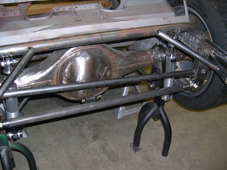

The frame rails are finished and welded to the floor pans
The housing is narrowed and the Moser axles have arrived
The custom shock/lower control arm mounts turned out nice. A friend at Evansville sheetmetal cut them out with a water jet machine. Cool!
The torque arm is finished and tacked place
Now to the watts link and then to the front suspension.
The cars here are so nice you almost hate to post pics. Very high standard here

Front torque arm mount is finished.
Panhard bar is done
Now onto the BRC anti-roll assy.

mainsy,
The project is coming along great. Just have not posted in a while.
Trunk floor and fuel cell are finished
rear wheel houses are finished (tough job on a vert. pics will explain)
motor and trans are in
headers are built
front suspension, radiator, rack etc. are done
pedals and Wilwood cylinder are in
Vintage Air unit is mounted and hidden
The fabrication should be finished in a couple of weeks then off to the exhaust shop. After that she should be ready for the paint shop.
