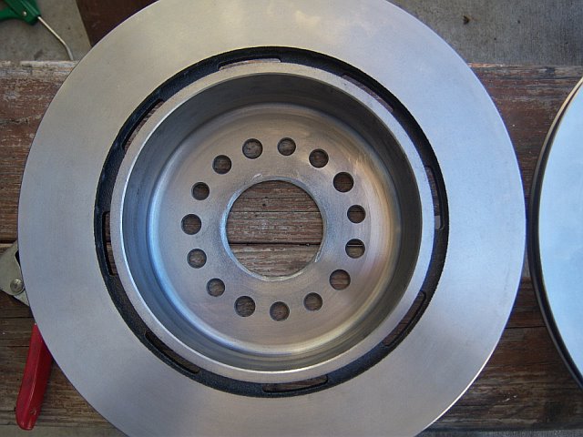

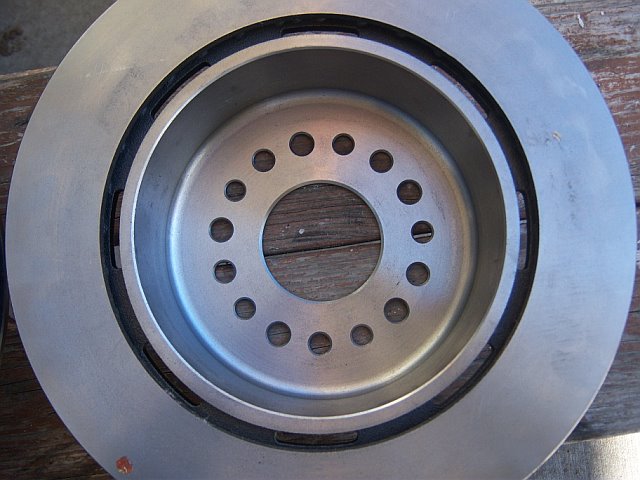

Grinded down the inside of the rotor and tried to keep the machined diameter. Put about a 45 degree angle on it. Seems to fit well now and the calipers also fit well. Thanks for the input from those who replied. I will post some pics of before and after grinding later.

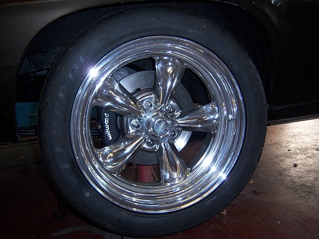

Default Pic of the rotors before and after
Here are some pics of what I did to get the rotors to fit. One pic is before and the other is after. last pic is when it was bolted up done
