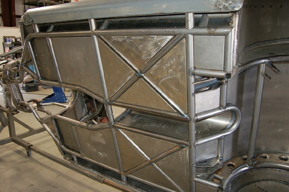

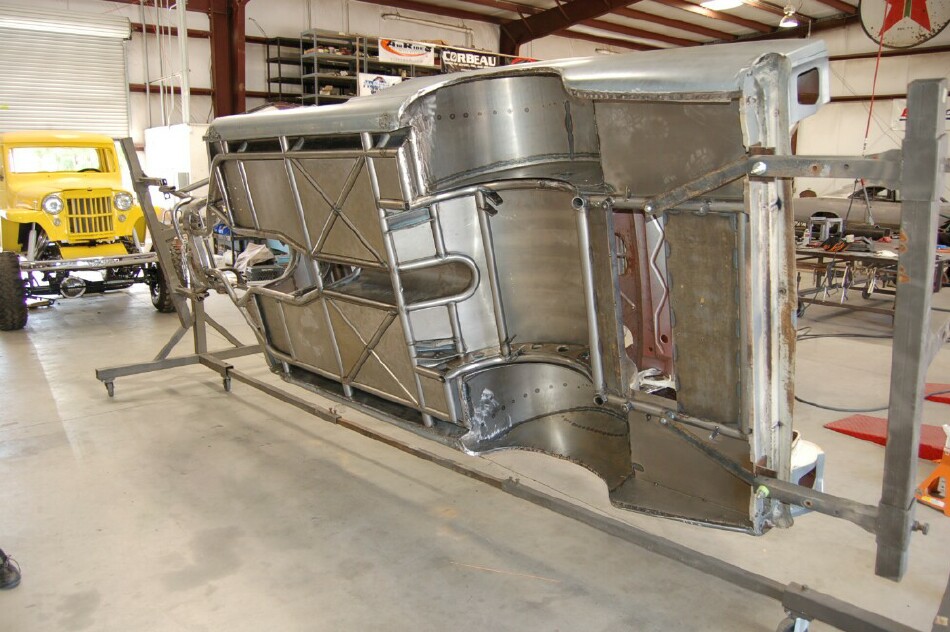

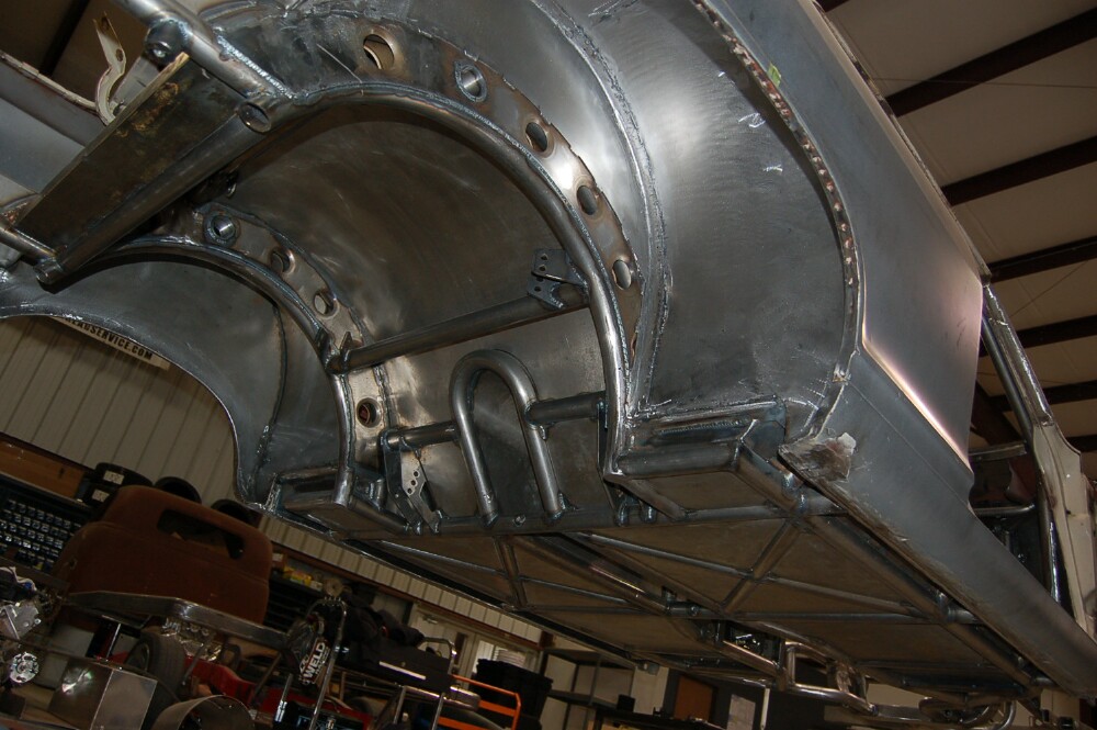

We we have her on her side to finish welding up som epiece on the bottom and getting her ready for Powder coating. The frame rails look awesome from underneath. We are setting the steering column drop today and seating up the seat tabs for the Corbeau seats. We will start the mods to the dash to install the Autometer gauges. The Exhaust is at Specialized coatings in Huntington beach, we are doing that in a titianium color.

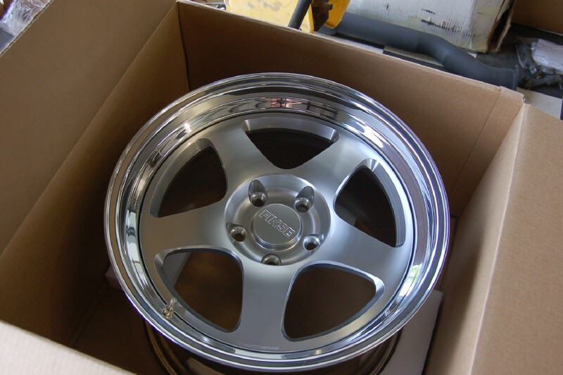

Oh and I alomost forgot the 18x12 and 17x8.5 Fikses arrived last week, They should look great with the BFG tires.

It's a work of art.
Too bad most people won't be able to see underneath because THE CAR SITS SO LOW!.... I like it!

looks great amazing fab work. whats the info on the yellow willys?
