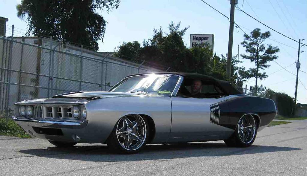

Here are two cars we did with the back tires you are looking at using. The cuda as the 335 tire and the camaro has the 325 tire. I hope this helps. I would use the 335 tire.
Good Luck,
Mike

What is the front rim and tire size on the cuda, Mike??
Thanks
John
Good Luck,
Mike
