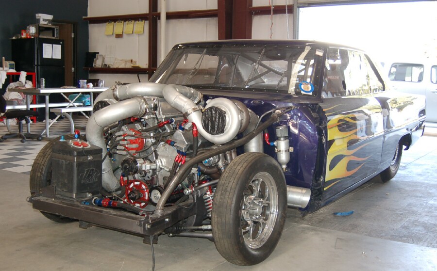

So I just purchased this twin turbo 64 chevelle that many of you have seen.
Awesome car! What I've always wanted. (would love to have built it, but 3 kids under 7 yrs. old makes it impossible right now)
However, I overlooked one thing. I live in New Mexico at 5500 ft. This car has accel gen 6 DFI(now outdated) . Guess what, I can't find anyone to tune it. So I've spent 4 days researching and bugging people. There are seriously some amazing people on this site... (ie. JodyB. Nelson Racing, etc. etc.) They have given me some great options which I will probably end up utilizing! However, they are all 14 hrs. away from me, so I want to make 1 last crazy effort to come up with another solution...
I have some crazy ideas....Is there anyone going to Sema that would want to do an overhaul of my FI system? It would be great advertising in the show to do it live Or I could upgrade my whole FI system, etc. etc.
Knowing thats a crazy idea, how about just someone in southwest that is reputable that can handle this. I'll accept any of your brainstorming. I'm not looking to do a $20k engine overhaul, but am willing to spend some money. My whole goal is to get it tuned correctly and have a more updated system that can be manipulated much easier.......

Job Spetter, @ Turbo People can do it over the internet. He does our dual
88mm sbc from the drag strip over a wireless connection. We ran a 7.54 last weekend in Fontana on our 4th pass with our new combo. He is possibly the best in the country. He tuned the Mustang in PHR this month also.
Plus Jobe likes the Accel software, that is what we use in the race car also
www.turbopeople.com
Rodger
