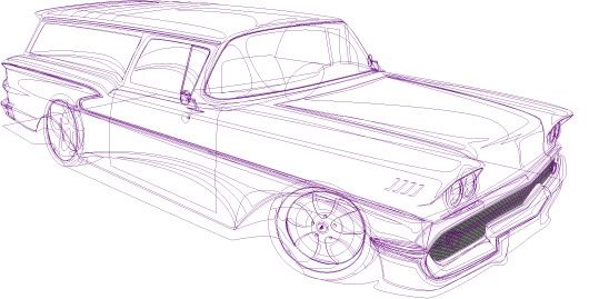

2. Use the pen tool to trace the sketch, starting by creating the shapes that will hold the majority of the color for the car. In this case I had a gray shape for the bottom half and a black shape for the top. This gives you a basic outline for the whole car. The pen tool has it's own palette that if you click and hold on the little arrow to the bottom right the pallete will pop up. If you go over to the arrow on the right of the mini pallete you can "tear off" the pallette and have it next to your art so you don't have to keep going back and forth to the tool bar to change pen tools. I usually use a bright green or pink thin stroke with no fill to draw with. These colors show up well above your background art and no fill makes it easy to get all your lines in. I occasionally fill them with color as I go along to make sure it looks right, then delete the fill and go back to creating lines. Here is a shot of the finished "wire frame".

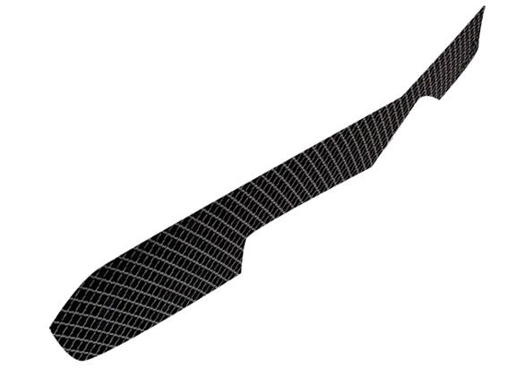

2. Sometimes you can use a little photoshop to speed up the process and/or get a cool look that would be difficult to create in Illustrator. In this case I didn't want to create a grille from scratch, so I chose a subject photo from the web, a late model Ford p/u, and tweaked the photo on photoshop to get the angle, stretch, and color I wanted. Read below to see how to do this with photoshop. Then I brought it into Illustrator and cropped it so it would fit behind the bumper without protruding past the line art. To do this, select the photo, and make sure it's embeded (window/links/menu drop down arrow on upper right/embed image). Then trace the basic grille opening on your car with the pen tool and make sure it is placed above the photo. (The hot keys for moving things front to back are Ctrl (or apple) +] for move above or Ctrl+[ to move below. Holding shift+Ctrl+[ or ] will send the object to the bottom or the top accordingly. ) Select the line shape and the photo by holding shift and clicking on both, then go to object/clipping mask/ make, or use the hot key Ctrl+7. This is what it looks like after it's clipped.
Select it and place over the opening, then use Ctrl+[ to place it in the shape order you want it, in my case behind the bumper. See wire frame photo above.

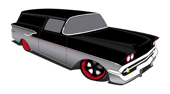

Here is the car after starting some shading on the front clip. I use the gradient tool on the color pallete for blends and for the light highlights like on the hood you can either use white and turn down the opacity, or if you don't want a "see through" shape, you can use a lighter shade of the same color. Easiest way I can think of doing this is to double click on the fill box on the color pallete bringing up the color picker pallete and then simply drag the spot to a lighter shade.
Here is the car with as much as I wanted to do in Illustrator and ready to import into photoshop.

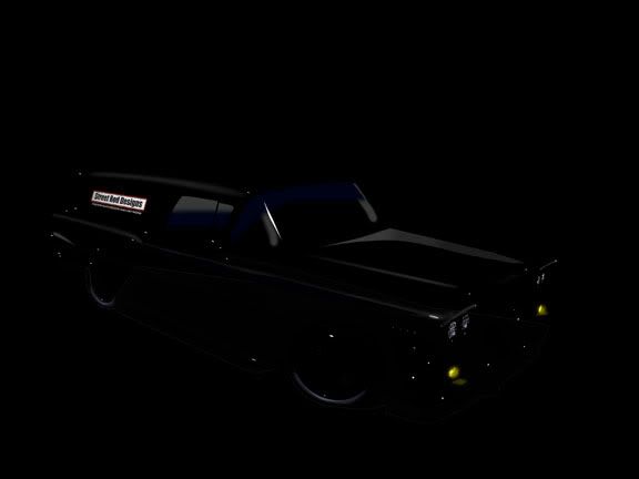

Once in photoshop, duplicate the original layer by using the drop down menu arrow in the upper right and delete the original by clicking and dragging it to the trash can. (There may be a better way, but I still can't figure out how to unlock the "background" original layer, lol!) You'll want to do this so you can tweak the original art if needed. Then create a background color layer and drag it below the original art layer. Then create a new layer above your car and using the airbrush tool start adding highlights and bling. Here's the photshop file with only my highlights and black background layers showing.

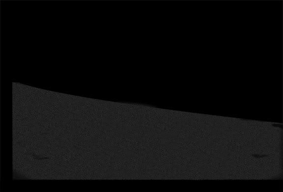

To create the road there's a way simple step. Use the pen tool and creat a shape of the road (the shape was already in my paths palete, I just clicked to select as above). With the shape selected create a new layer above the photo and under your car and go to filter/add noise. Play with the settings on the noise palette to get it where you want it. Simple as that, you've got a road. For a cool effect you can put a slight motion blur on it and then do a radial blur on your wheels and it looks like the car is moving. I used the burn tool from the tool palette to create a couple stains on the pavement.
