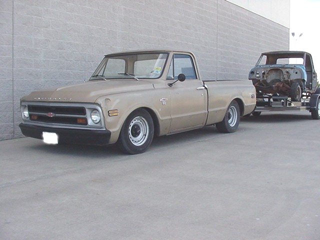

Here was my version till I sold it last year. I have a 63 chevy in the shop write now that I'm designing my own pro-touring frame for and hope to start making them as well. i 'm lacking man power so unfortiantly for me it's a slow process. To say the least there is a market for these trucks.
Follow us on Instagram = @bentcustom
www.bentcustomandperformance.com
