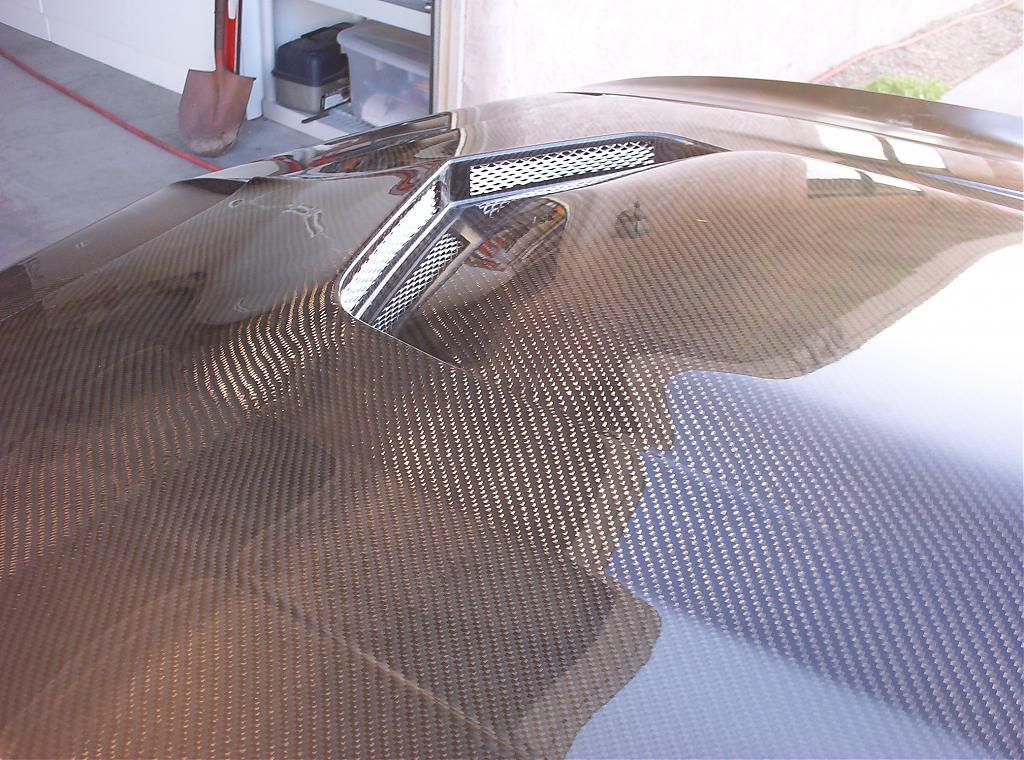

Spoiler is from spoilers.com...rear wing I made out of aircraft grade carbon fiber..

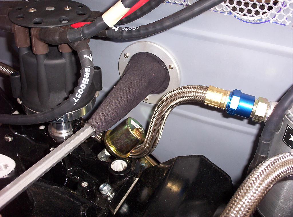

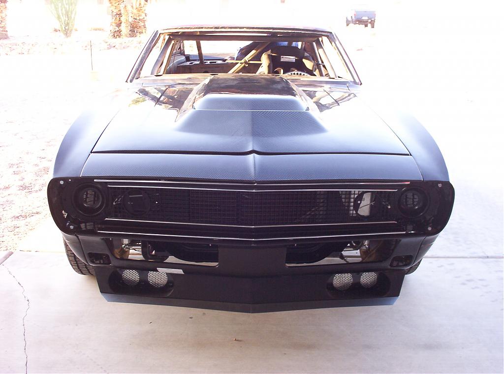

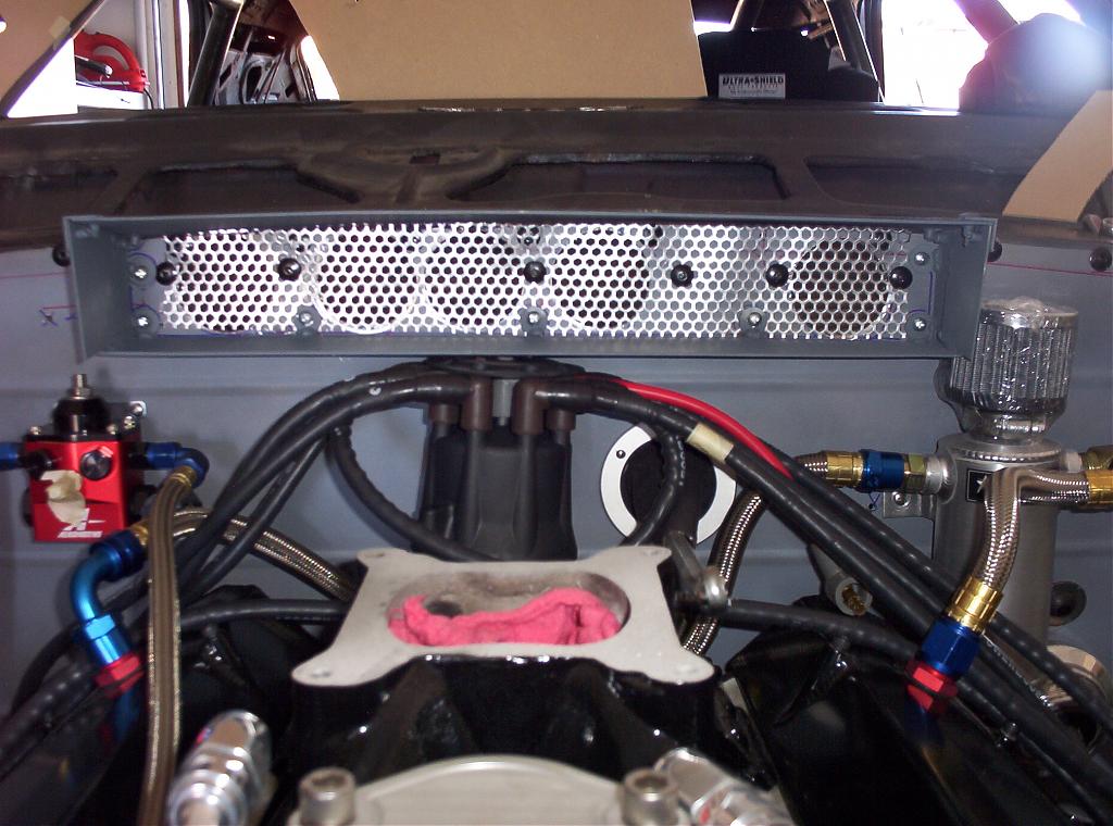

some pics for whom are interested. car is in progress and in the mock up stage...car will be black and the interior will be white along with roll cage
Old 09-21-2009, 07:54 PM
deuce32's Avatar
deuce32 deuce32 is offline
Join Date: Dec 2007
Location: lake havasu city az
Posts: 255
few more
