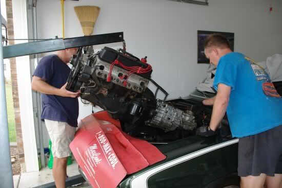

It's been a solid car for the last 7 years, enjoying many miles on various cruises and Power Tours. The 383 stroker and Tremec 5-speed performed well, but I've had the LS bug for years now. Drivability, horsepower, reliability, gas mileage, etc., plus the fact I wanted Air Conditioning for the cruise home. Power Tours are great, but as some point you just want cool air and quiet surroundings. The time has come.
2009 Power Tour with daughter, priceless.
Stroker before the pull.
Thanks to Craigs List, the 383 is going to a new home.

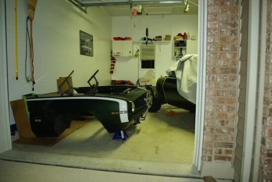

I know, should have pulled front clip first, but I had to remove the motor quickly for the new buyer.
Removed old heater core, and took steel "bolt-in-plate" from Vintage Air package and decided to cut and weld into place for smoothing the firewall. I know many folks hide the lines underneath the fender well, but I decided to go this route. Just going to keep in simpler and use all the hard lines from my Vintage Air kit as they were engineered to by used. First time ever welding so this was a learning experience for me. I can say afterwards I know more now.
I'm much further along than the photos show, but will have to post more later. I hope you all enloy this as much as I've enjoyed reading all the posts from everyone elses builds. Feel free to ask any questions!
