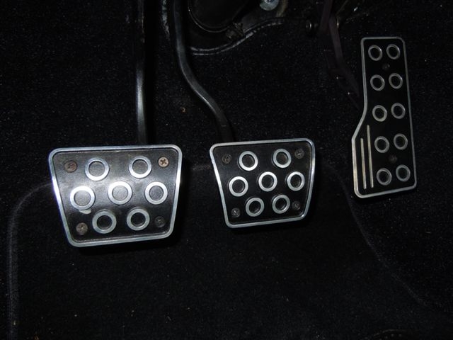

If you will look to the left and click on Modo Inovations, you will see the gas pedal and matching pedal covers. I am not running a drive by wire so I used the Lokar gas pedal with the Modo pedal. I will see if I can dig up some pictures for you.

that you posted above
Here are the pics of my Modo pedal covers

Default Thanks for the photo!!
Payton,
Pedals look nice. I prefer function and feel over "BLING" and shine and those look like they are all business!! Do they grip pretty good? From a grip perspective, how do they compare to the OEM rubber pedal covers?
Regarding the pictures from the Street & Performance web site, that pedal modification is required if you are using the fabricated bracket that is described next to it. That is why I'm using the DSE bracket.
