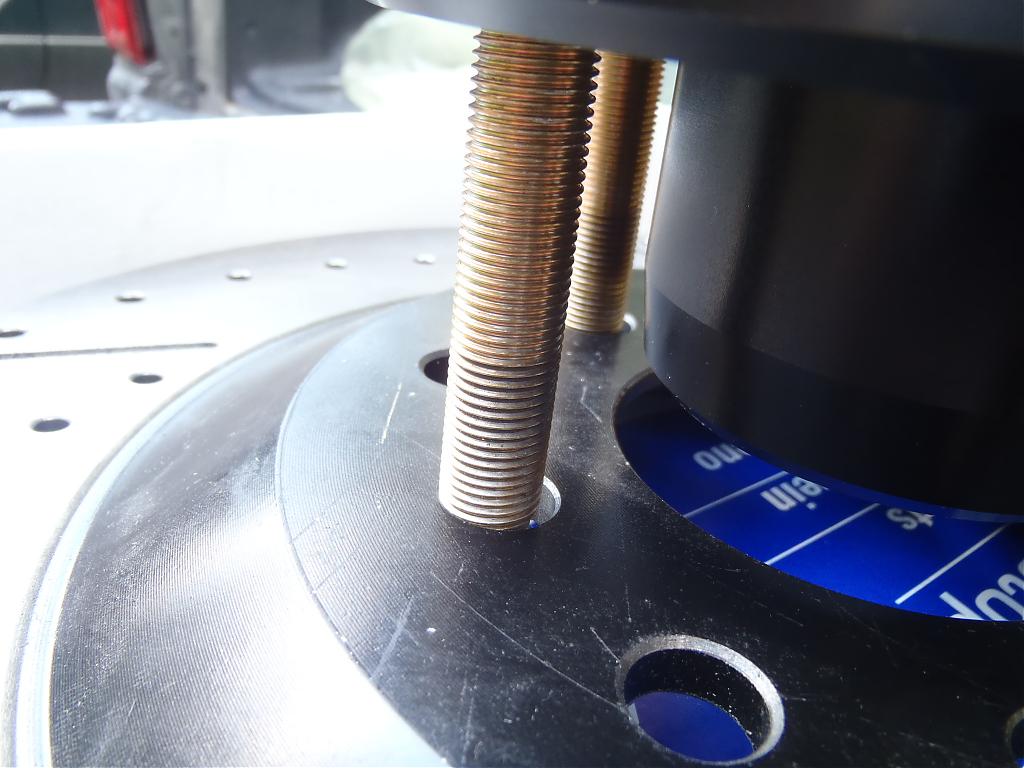

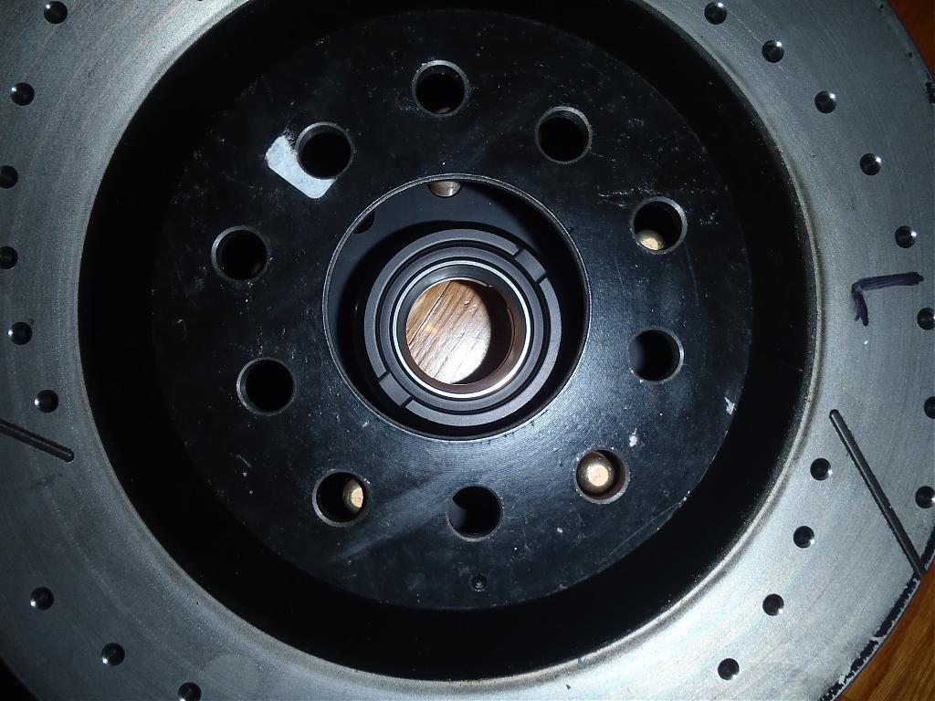

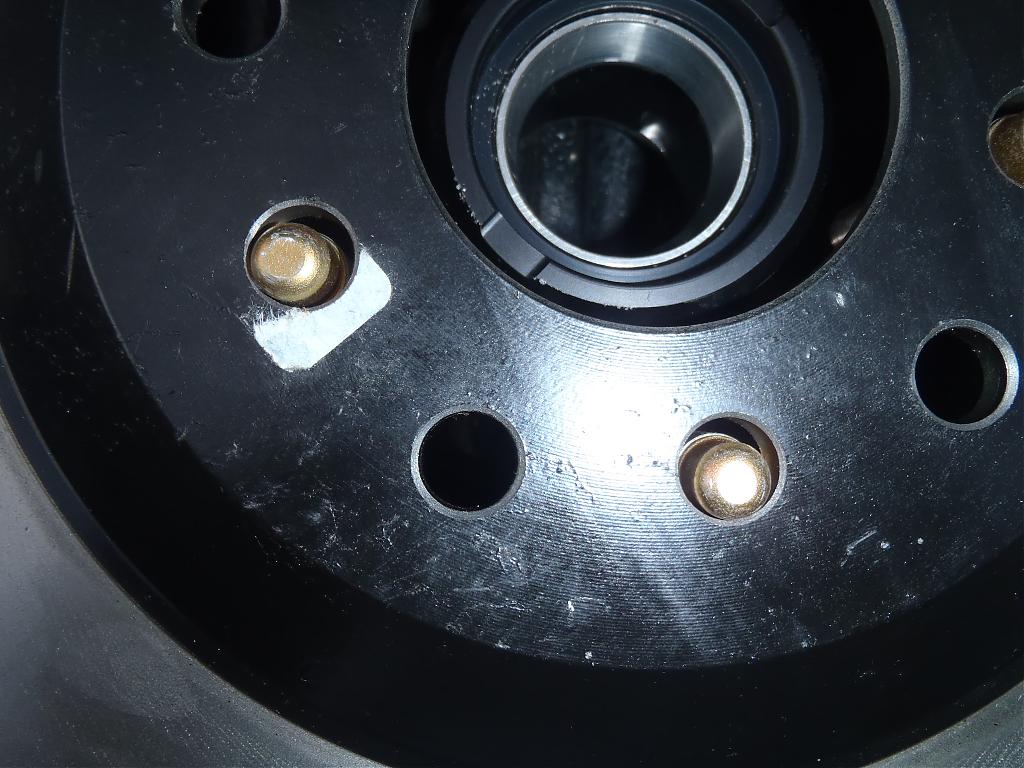

I just picked up some Kore 3 brakes for my Dodge Dart that uses Mustang II front spindles. The first thing I went to mock up was the rotor to the hub, if you look at the picture there is no way it will fit over the wheel studs. Has anyone had any problems with these?

Don't take this the wrong way but the adjacent holes look to be in perfect position. I'm assuming you already tried that though.
Off course...
Pretty sure the Darts up to 73 or 74 had that oddball 5 on 4" b.c. which is too small for those rotors. They look to be for the normal 5 on 4.5" and 5 on 4.75". You'd either need different rotors, or have the hubs re-drilled. I'm thinking the hub re-drilling will be the only way to go, because there can't be many rotors in that small bolt circle.
Both the hubs and the rotor came from Kore3 , I ordered it with 5 on 4.5" so that I could have the bigger bolt pattern. I checked the hub and it matches up with a 5 on 4.5' wheel so I'm guessing the rotor they use must be drilled in house and it is drilled wrong.
Yeah, you'll need to call Tobin on that one. He's a good guy, I'm sure he'll know what's going on.
