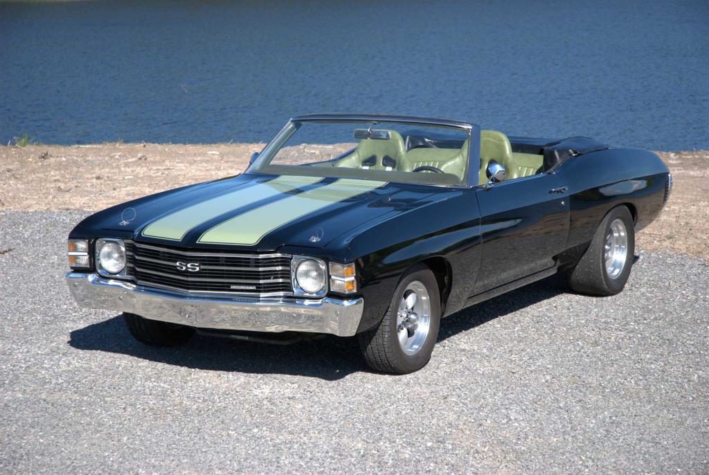

bought the car in 2005 and been building this version since 2009 and hoping to make it ready in 2013. My idea is to build 70 1/2 version of the Chevelle like the camaro had. im gonna keep the 1971 rearend and 70 front chevelle with el camino 70 front bumper so all the lights will be round.
i try to keep the old story short , this i look it had when i bought it.

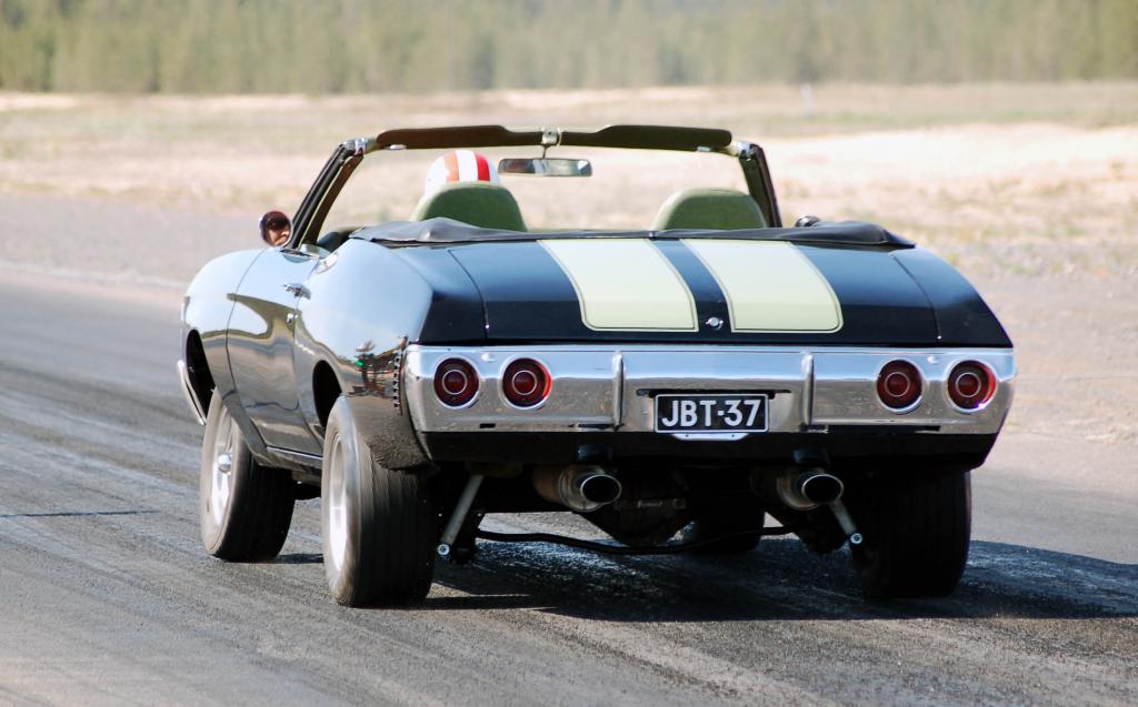

in 2007-2009 we build it to look like this. best et was 11.2 sec with full exhaust. First it had 509 bbc and procharger and later 632 bbc with powerglide.

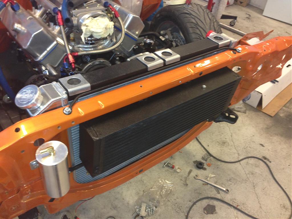

radiator brackets done
