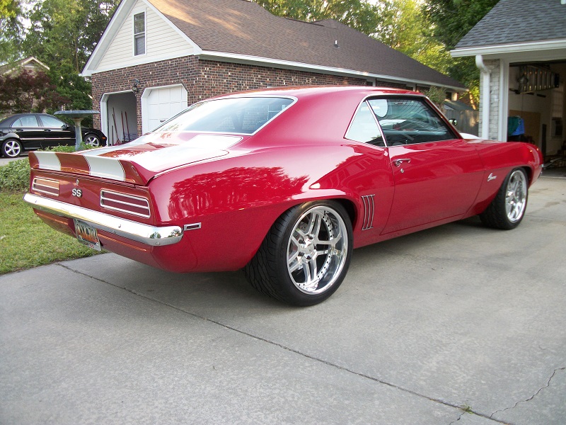

69 camaro, mini tubs. Is any body running 12's with a 60"/stock rearend width? I'm sure this requires big back spacing. Interested to hear numbers/facts. Pictures would be great too. Thanks!

I am running 18x12 w/ 8" B.S. on my '69 Camaro with stock width 12-bolt. I have around a 4" outside wheel lip on these wheels, but that amount would be different depending on wheel design.

Yes, I rolled the rear lips 19 years ago when I restored the car, knowing I would always run wide tires. The front 18x9" have 5 3/4" B.S. but would recommend 6" to give a little more clearance on the outside fender lip at full lock.

Sick! Absolutely love it, will you please share some pictures toward the rear of the car? Thanks!

I will comply....... These pics were taken when the suspension and wheels were just installed. The car is about 1/2" lower now.
