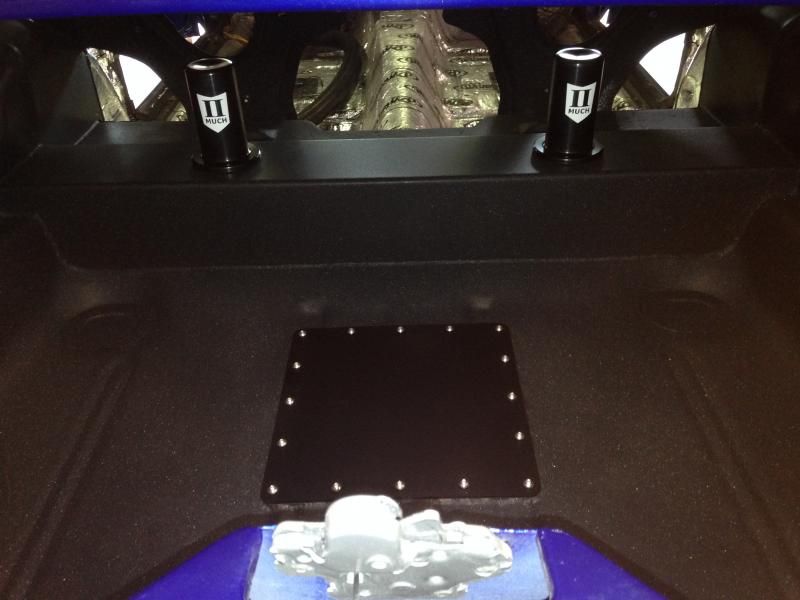

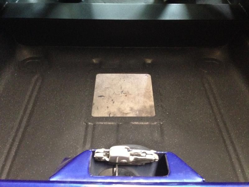

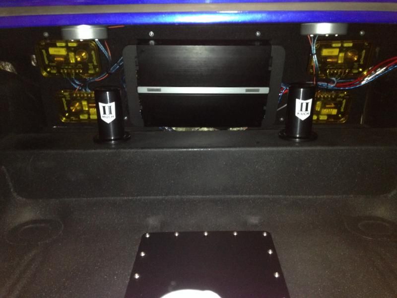

I got some work done in my trunk area this weekend. The hole in the middle of the trunk is one of Detroit Speeds new products, their Fuel Pump Access Door Kit. The Fuel Pump Access Door kit allows a bolt on cover to be located above the fuel pump so the fuel tank does not have to be removed to change or service the fuel pump. This is definitely a nice feature if you've ever had an issue with your fuel system, which I have. Also I mounted a Fuel & Differential Vent in the trunk. I went with II Much Fabrication vents which I also got through DSE. The II Much Fuel Vent helps eliminate fuel spills and odors and the diff vent will help with running at the track and pushing oil out of the rear. These vents are extremely nice quality and easy to mount. I just used a hole saw the exact size I needed. It's an easy upgrade. Once I had those mocked up I re mounted and re wired my stereo equipment which is a 500 watt Polk amp which I'm running to all Polk Momo speakers. It's getting there! Hopefully get the rear back in this week.

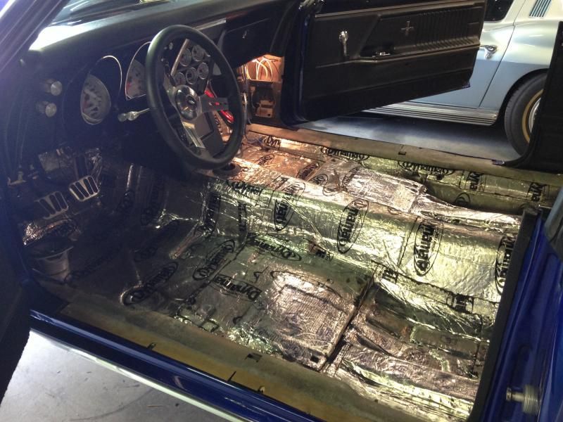

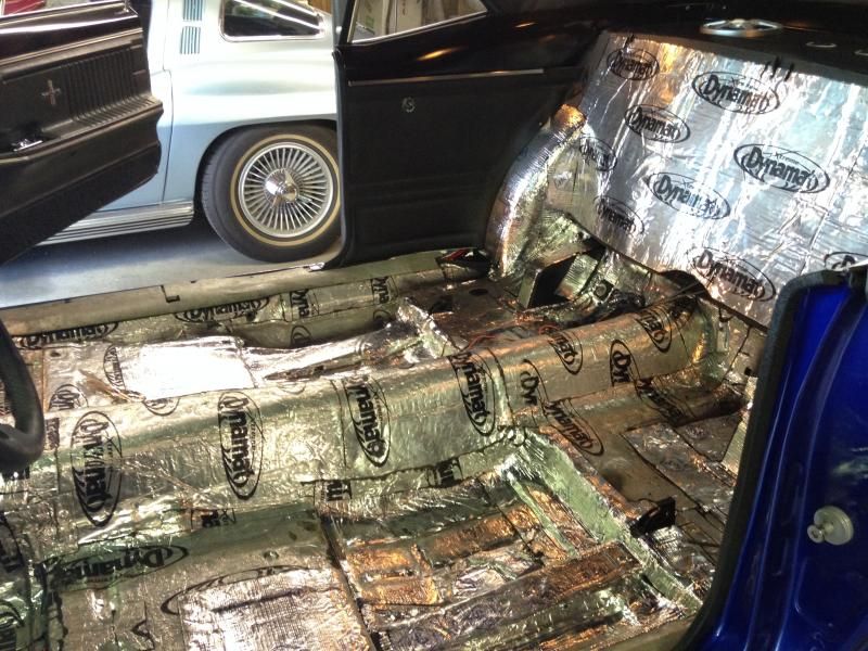

Starting to put the interior back together too...
