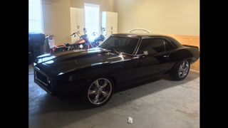

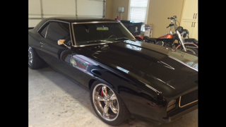

Here are a few pictures, I will get better ones of the body. The interior needs some work in my opinion and I plan on addressing it over the next couple of months. I appreciate the advice GregWeld!

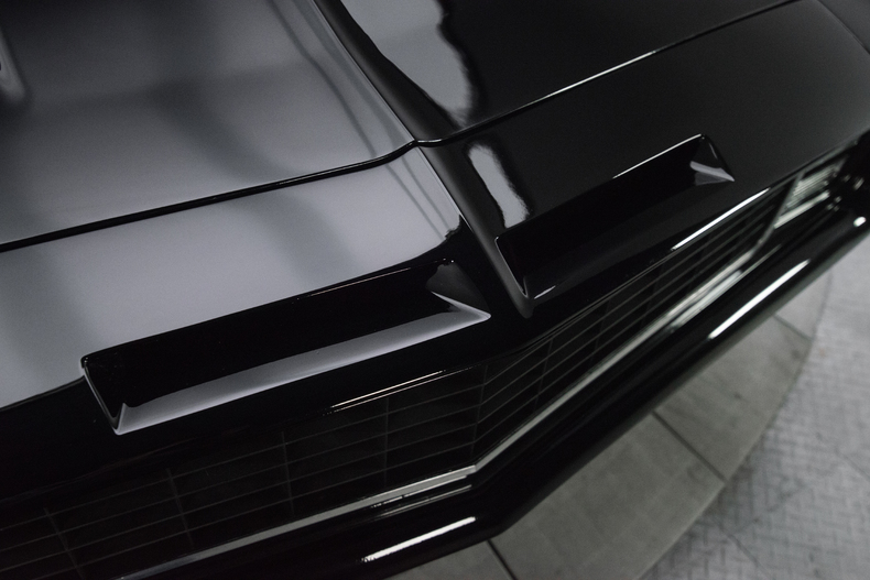

The Iphone pictures dont do much justice above. I will be sure to take some good ones. The real work in this car appears to have gone into the Powertrain and the body work. The Vents in the hood are a nice touch along with the "shark fin" louvers are "functional" I'll have to take closer pictures when I get to the house with a camera better than my iphone...
