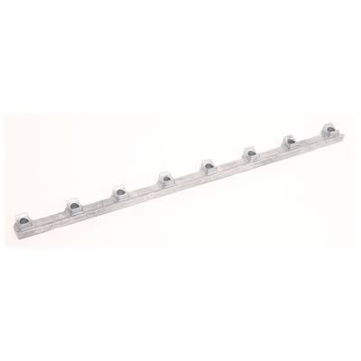

Here is one of the three that are loose.
Would cha look at that !!!
The rocker is not fulled seated in the rocker stand or the rocker stand is damaged.
