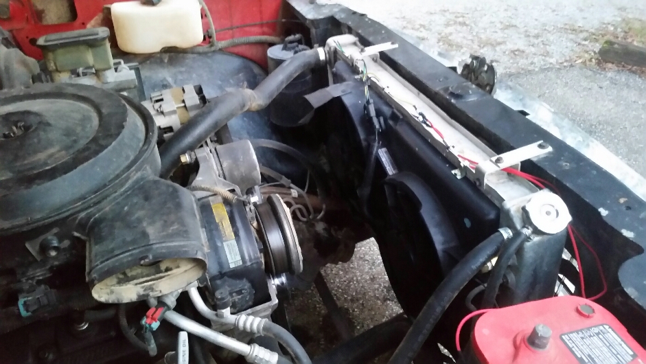

Added a electric fan add and wired in with Derale controller and deleted the mechanical fan.
