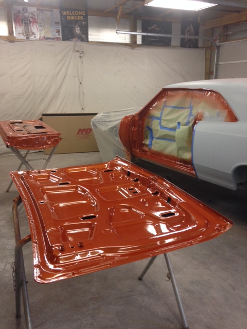

Old 02-12-2016, 07:44 AM
chopperrob chopperrob is offline
Join Date: Feb 2016
Posts: 18
I chose "Atomic Orange Pearl" super nice color that will flop a lot out in the sun.
