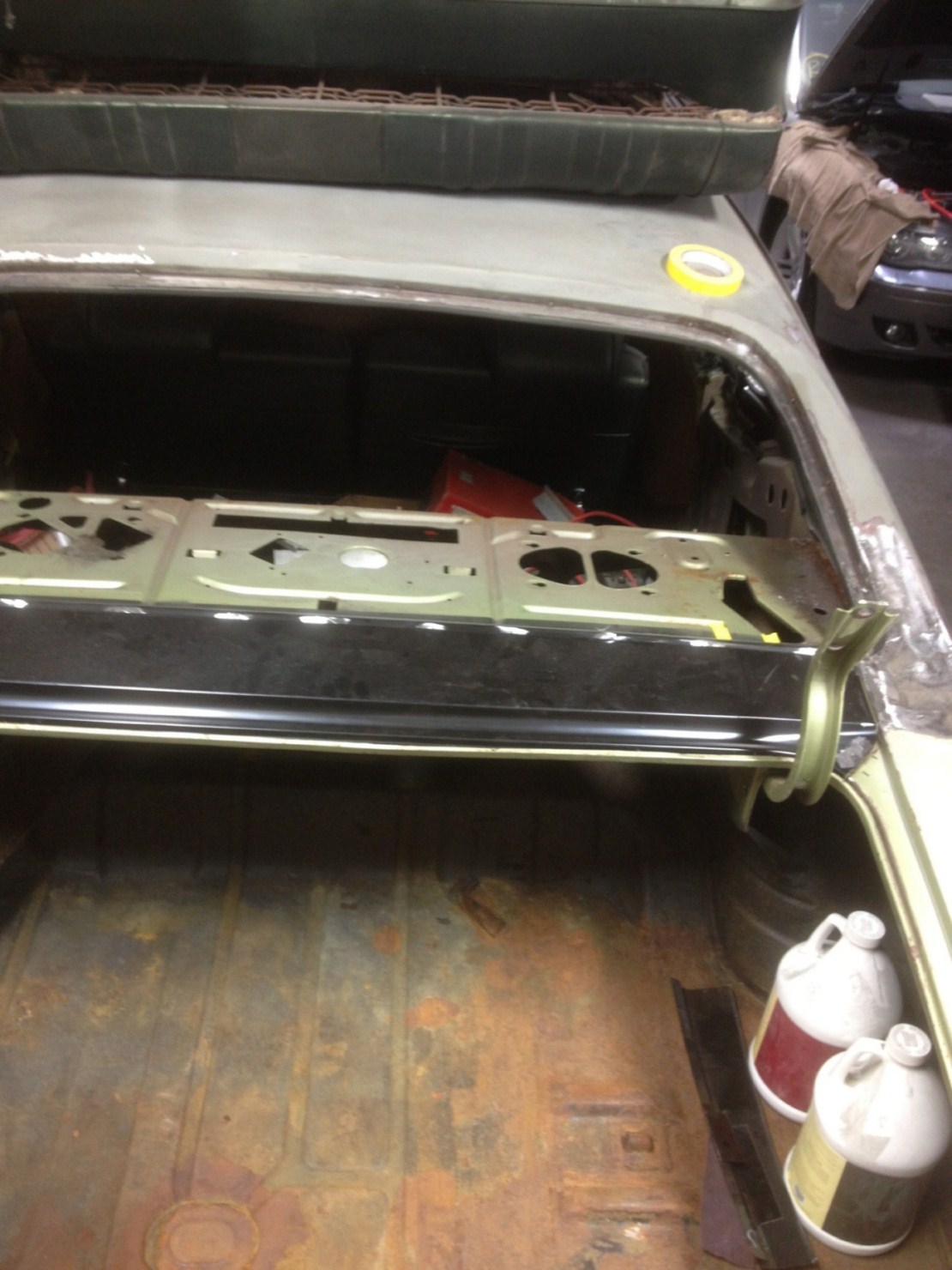

Digging into the body work the sail panel below the rear window had some rust and some of the rear window frame needed repair also. I had a neighboring shop repair that and prep the rest of the body, weld some of the trim holes closed, and put it in black primer.
At that point my good friend Chris Coffey was leaving the area with an empty trailer back to Nashville, TN (he was out doing some fab work in the area) and asked me if he could take it with him so he could work his magic. Realizing that my progress was slow and I don't have the skills to do a full cage that actually looks good, a turbo system that would be reliable, and other touches the car left with him! He has been a fabricator for pretty much his entire career and would work on it during his slow times and charge me a discounted rate as a result.

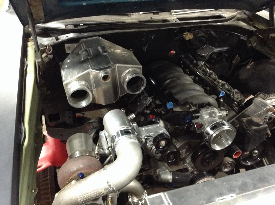

I sold the TC78 turbo and went with a GTS76 billet unit (1200hp rated), bought a beefy CG&J custom radiator, Holley Dominator EFI, chromoly tubing for the rollcage, and the hot side parts for the turbo system. 2.25" crossover tubing using truck manifolds and Vbands welded on them. Downpipe is 4" into a Badlandz e-cutout and then dual 3" into 4 mufflers for super stealth mode when closed.

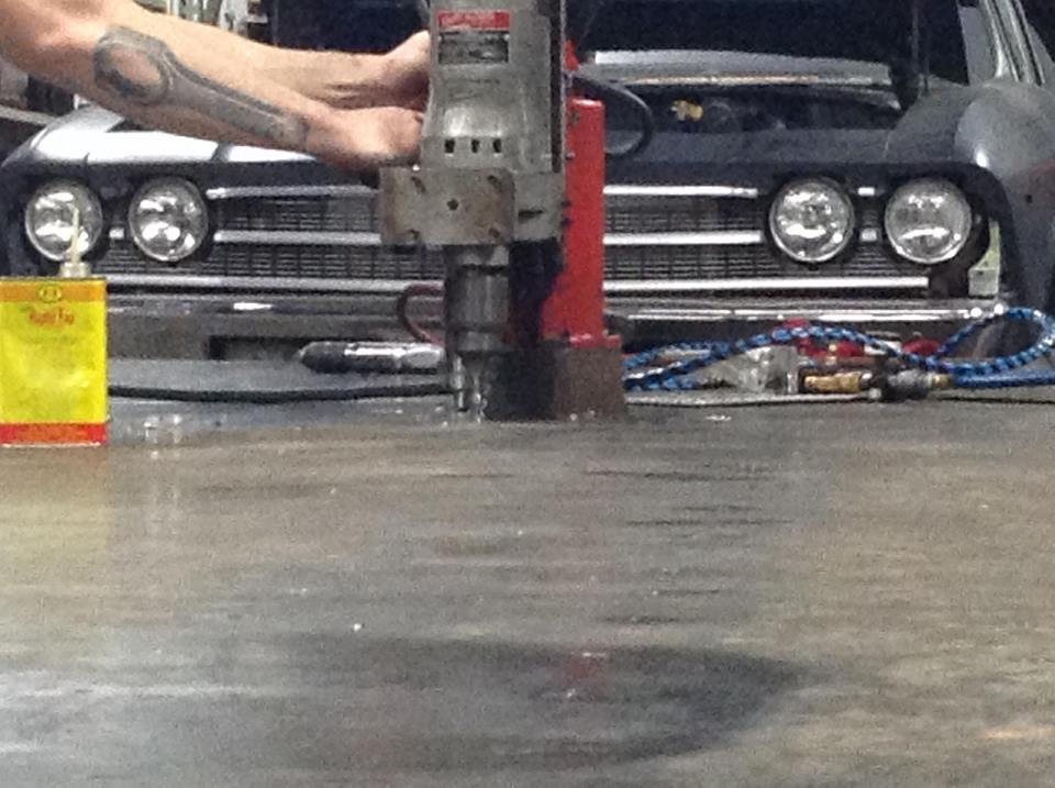

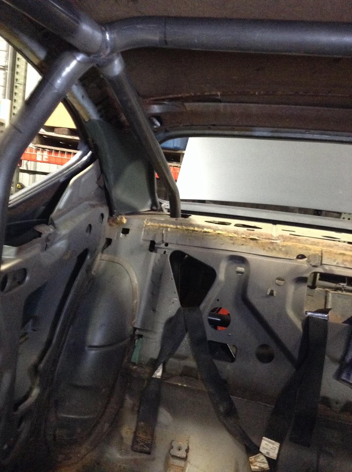

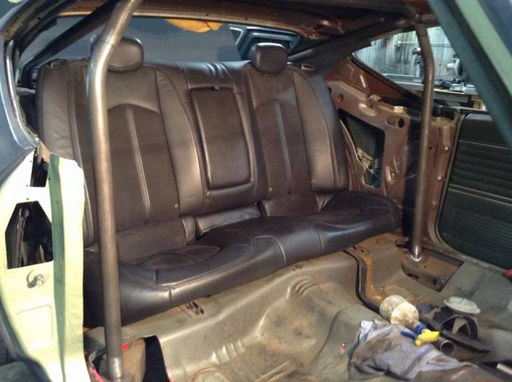

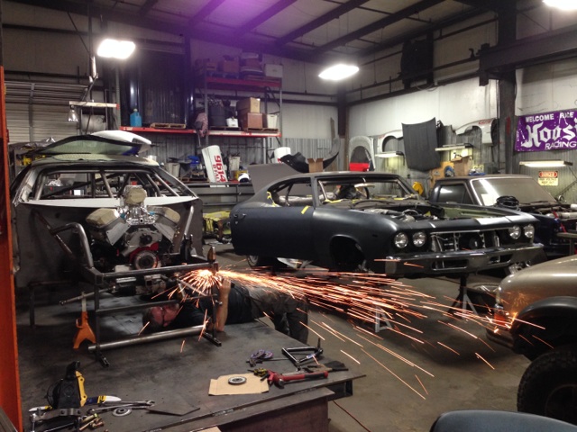

onto the cagework.... Coffey Fabrication on it! Chris builds Bonneville salt flats landspeed cars for a hobby!
The first picture is the frame table Chris and his friends made from plate steel and then drilled in something crazy like 350 threaded holes into it!
The CTSv rear seats need to go to an upholstery shop to be cut and fitted properly; however they do sit in there nicely.
Front seats were pretty easy to install.... the wiring to control them is the next challenge.

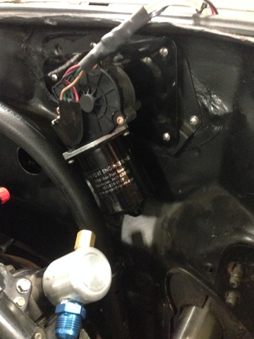

Newport Engineering wiper motor.... few more of the turbo progress.

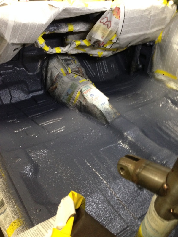

Flew out to Nashville last fall to visit and get some work done on the car I didn't want to waste Chris' time on. Knocked out about 40hrs on the car that week and prepped all the floors for Lizard Skin heat and sound barrier. It was a ton of work; however I feel it will really help in the end. I also installed the 4" aluminum DriveShaft Shop driveshaft with billet 31 spline yoke in the car. It is beefy.
In the first picture that is a '95 Firebird landspeed car project with full chassis built on the table, 540ci twin 88mm turbo, Bruno trans, Winters style quickchange rear, and other goodies to shoot for 300mph this year at SpeedWeek.
They are feverishly working on it! That picture is from last fall.
