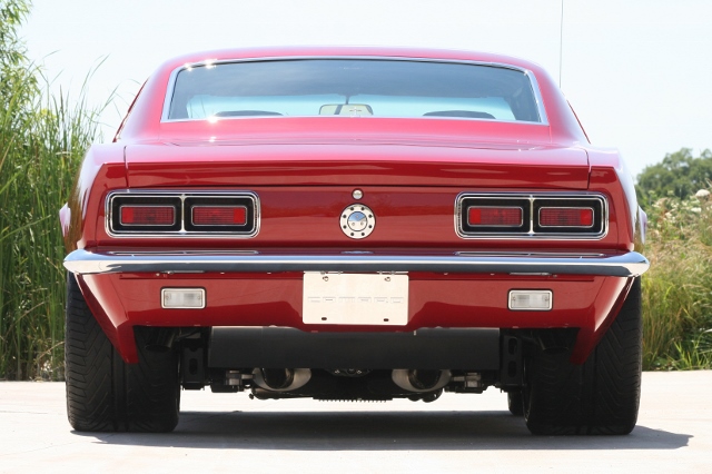

I'm new to this forum. Thanks for allowing me to join.

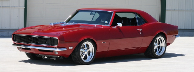

This 68 Camaro took 10.5 years to build with long breaks in between. We started on August 31, 2002.., The final bolt was installed on March 27, 2014.
This car was built primarily with hand files, a welding machine, tons of sandpaper, muscle and grit and sweat, and good friends. High tech equipment just wasn't that available of affordable to us.
"This car was all about being high performance. It had to have excessive G-forces forward, superior handling, and must stop like a dog hitting the end of his chain."
We wanted the outside of the car to be sexy, not just pretty.
We wanted the inside of the car to have a new car feel, nothing too radical, simple but nice.
When it came to the engine compartment, trunk, and undercarriage, it had to have an industrial, almost nuclear quality about it. No engine covers or trunk upholstery to hide anything. We wanted the guts to show.
So here it is. Take a look. And by the way, many different people were involved in this build. Thanks to all of them, too many to mention here.

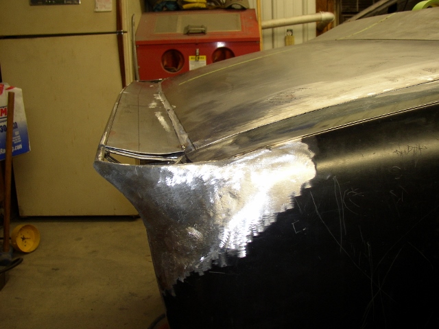

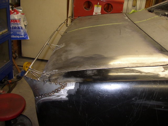

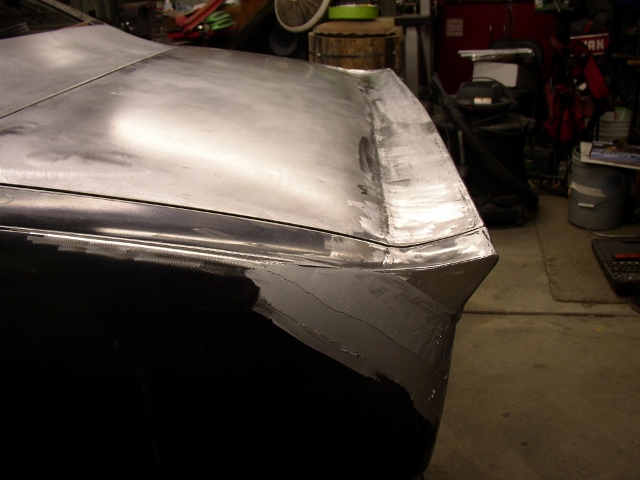

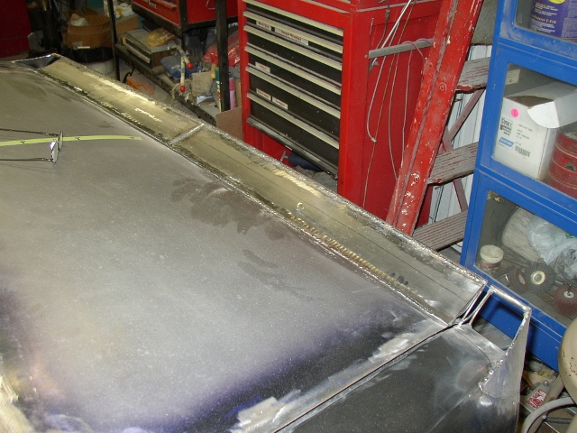

Clean and classic that will never go out of style. Great job. Do you have any build pics? Would like to see that rear spoiler fabrication.

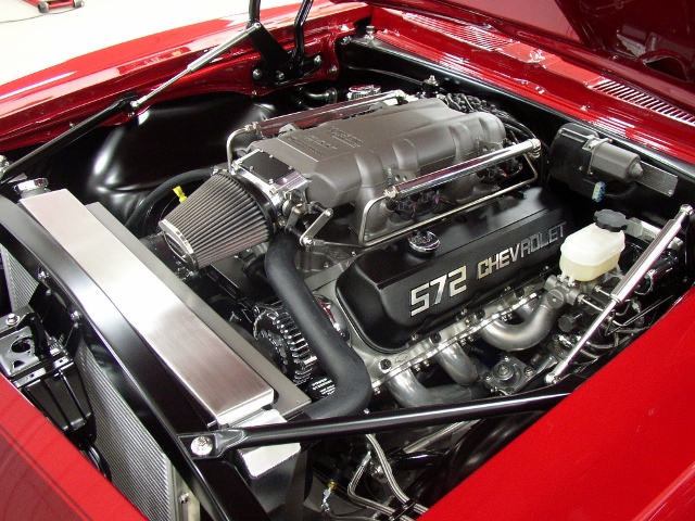

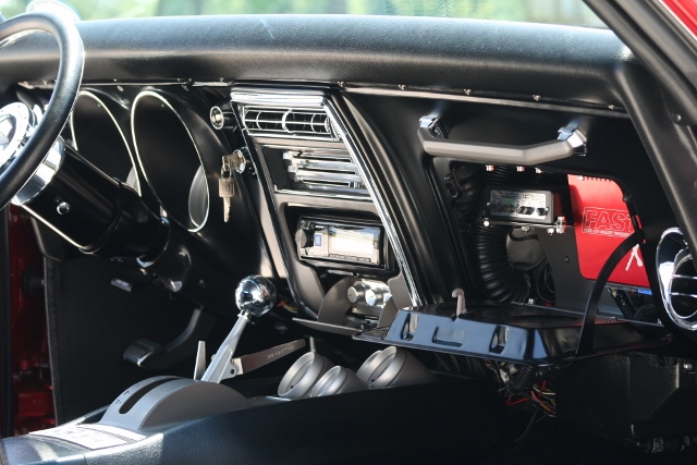

Engine is a 572ci tall deck big block with Lunati custom EFI grind roller.
EFI is a FAST XFI version 2.051 full sequential with adaptive learning.
Intake is a custom GM/Wilson piece CNC ported with 60lb injectors.
Fuel system is exclusively nuclear grade Swagelok components.

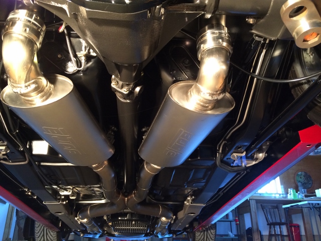

Exhaust is dual 3" 304L stainless with Borla mufflers.
Tranny is a 4L80E controlled by a PCS simpleshift controller.
Torque convertor is a billet lockup unit from Mark Bowler.
Rear axle is a 12 bolt TruTrac with Ford Torino bearings and Moser axles.
Suspension includes Detroit Speed front and Quadralink rear, Koni shocks on all four corners.

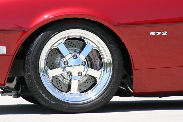

Front brakes are 6 piston monoblocks by Alcon/Baer on 13.5" rotors, rears are 4 piston Baer SS4+ modified to fit 13" rotors. We also went Hydraboost.
Steering is by a tuned DSE 600 gear.
Exterior mods include custom billet hood grilles on embellished SS hood,

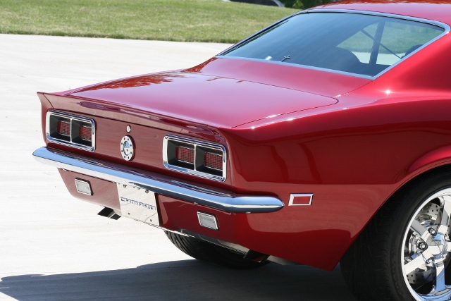

handmade emblems, welded steel rocker panel extensions with extensions in front and behind wheel openings, welded steel rear spoiler, billet steel fuel cap, shaved bumper bolts, shaved valve stems, custom made German gas struts for hood and trunk lid.

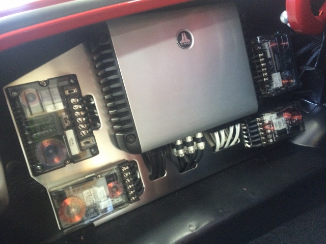

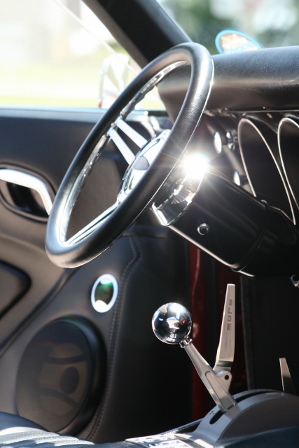

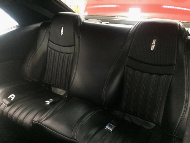

Interior mods include Luxor II custom 2 + 2 interior, GLOE shifter with handmade steel console inserts, trunk mounted seat belt retractors, stainless steel battery box, Focal/JLAudio/Alpine stereo system, brass machined center trim with hideaway HVAC controls, pushbutton start, lighted package tray, American Autowire wiring, transmission Guardian.

sd67, here's a few build pics of the rear spoiler.
