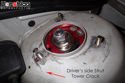

The second common weak point on the E46 chassis, as with many McPherson strut cars, is in the actual strut towers. The sheet metal is a bit on the thin side and virtually all of the vertical suspension loads pass through the strut and into the chassis via these two towers. With a big enough impact you can deform or crack the sheet metal here. It's even worse with sticky race tire loads. Sometimes the towers develop cracks simply from fatigue - again, soft bushings allow for a lot of extra squishy movement, which flexes the metal over time.
Below is a common upgrade we do on many BMW chassis, where we reinforce the tops of the strut towers. The damage shown on the silver E46 M3 track car below is a perfect example of why this work is needed.
This customer saw the tower reinforcements done on the Chainsaw Massacre E46 M3 CSL-clone and wanted the same thing done to his dedicated M3 track car. Good thing, too - when we pulled the strut tower brace off we found a series of massive cracks hidden from view, which you can see above.
The cracks were each "drill-stopped", TIG welded, sanded smooth, then a pair of the BMW E46 reinforcement plates were welded into the towers from underneath - effectively doubling the thickness here. The areas were primed and the car went back on track.
