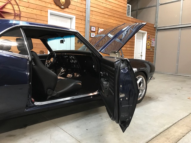

Here's how she started the day
Attachment 64006
By this evening I had the interior out and all the fluids drained.
Attachment 64005
