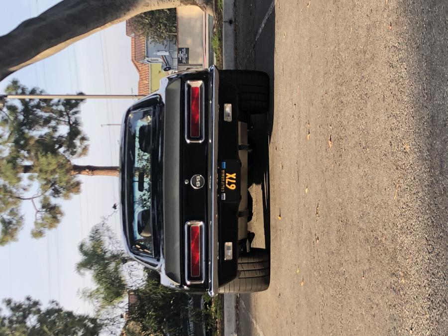

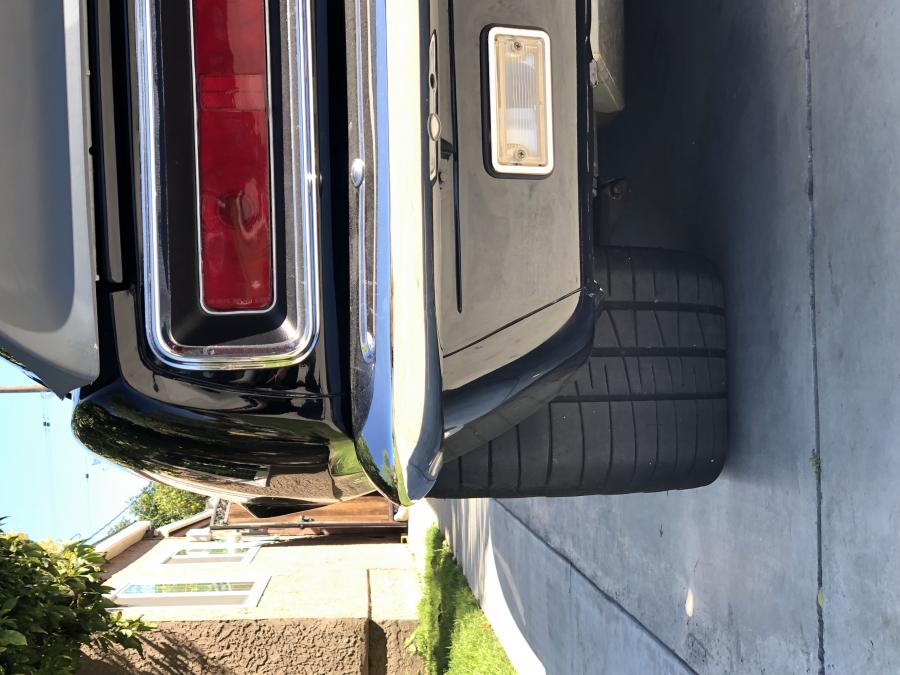

No not right now. My car is on DSE leafs right now with 335s. 4-link kit should help me put some 12 inch rims with those 335. Probably going to roll the lips to do that. I posted this on the thread for re-assurance. From what it looks like it’s a good suspension kit. I’m going to start ordering the front suspension soon. What size rims do you have up front with those 275s? And BS. Does it drive well?

I worked directly with Forgeline for sizing and BS. Your brake kit will have a big effect on BS.
I am running 18x9.5 with a 5.75” BS. 5.5”BS would have been fine for me, as the Kore3 kit is .25” narrower than the Baer kit that Ridetech used when designing their kit. The 5.75” BS I chose allows me the option of running a 1/4” spacer or not to fine tune the track width and clearance to the inner and outer fenders.
I spent months researching BS and wheel sizes.
Matt’s Classics and Forgeline were great to deal with and I read everything I could find from Brett Vokel and Rod Prouty before I made my order.
I can’t say how it drives as I’m not quite there yet. Might get to take it around the block this fall. It seems quite stiff sitting in my garage, but I have not made any shock adjustments and the car is not at full weight yet.
