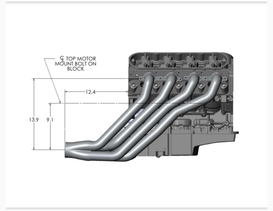

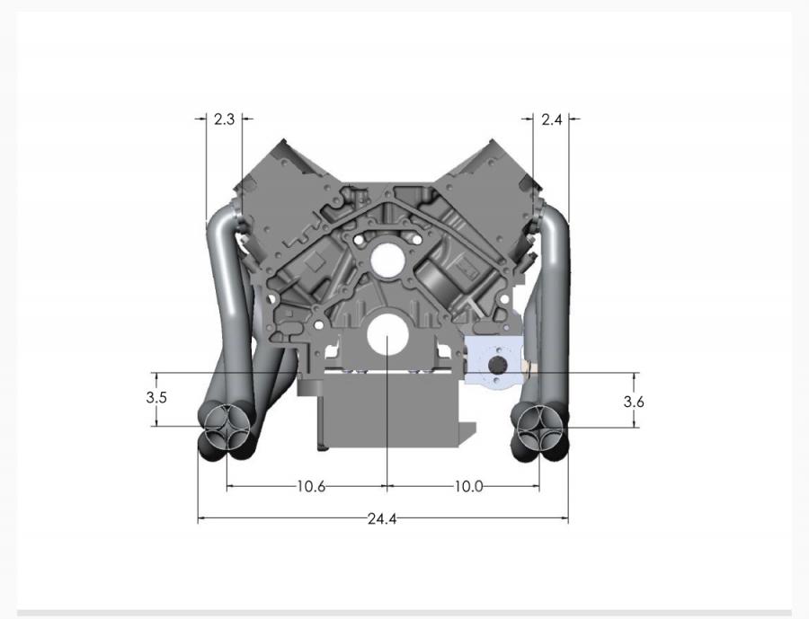

That was one of my main concerns. That I didn’t want them to hang low. Jim, the owner, assured me they won’t hang low. He sent me these CAD drawings.
