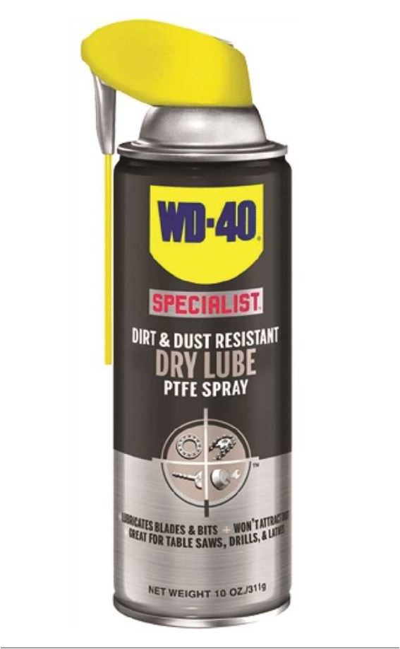

I have experience with just about every hoist out there, and yes, there are some points that are indicated not to lubricate because the lube acts like a dirt magnet. Once the dirt is in the lube, it becomes almost as bad as valve lapping compound (!). On those points, I have become a HUGE fan of WD40's Specialist Dry Lubricant - awesome stuff, as it puts down a dry film of PTFE that doesn't pick up any dust and dirt.
The cool part is that you can just about firehose a point to let it really soak in and penetrate, yet it then dries to the touch. Phenomenal on garage doors too.
