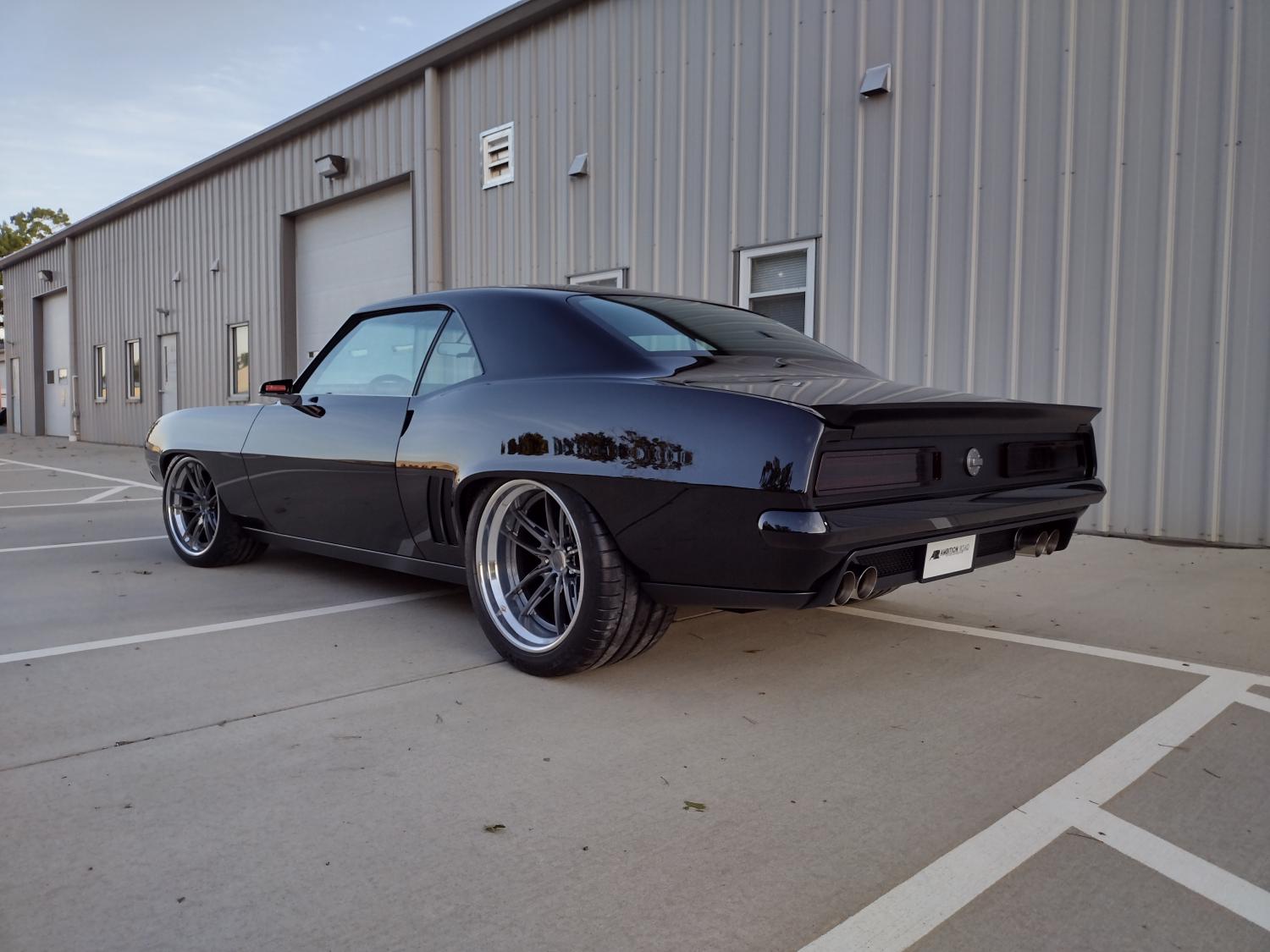

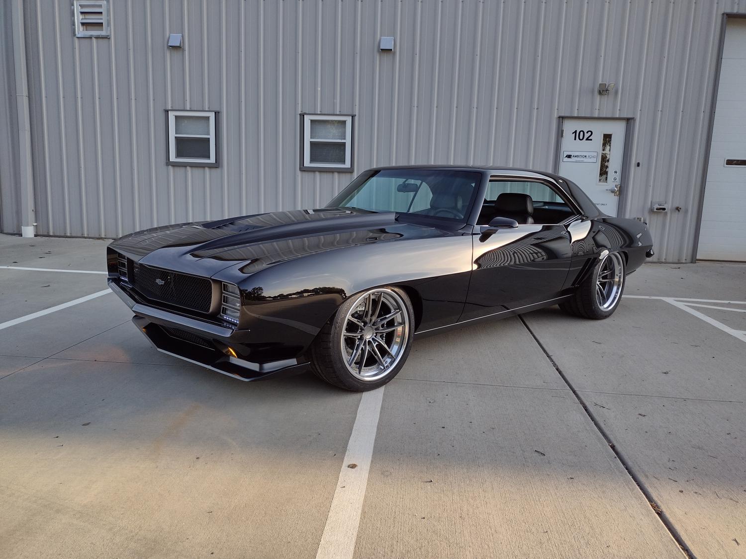

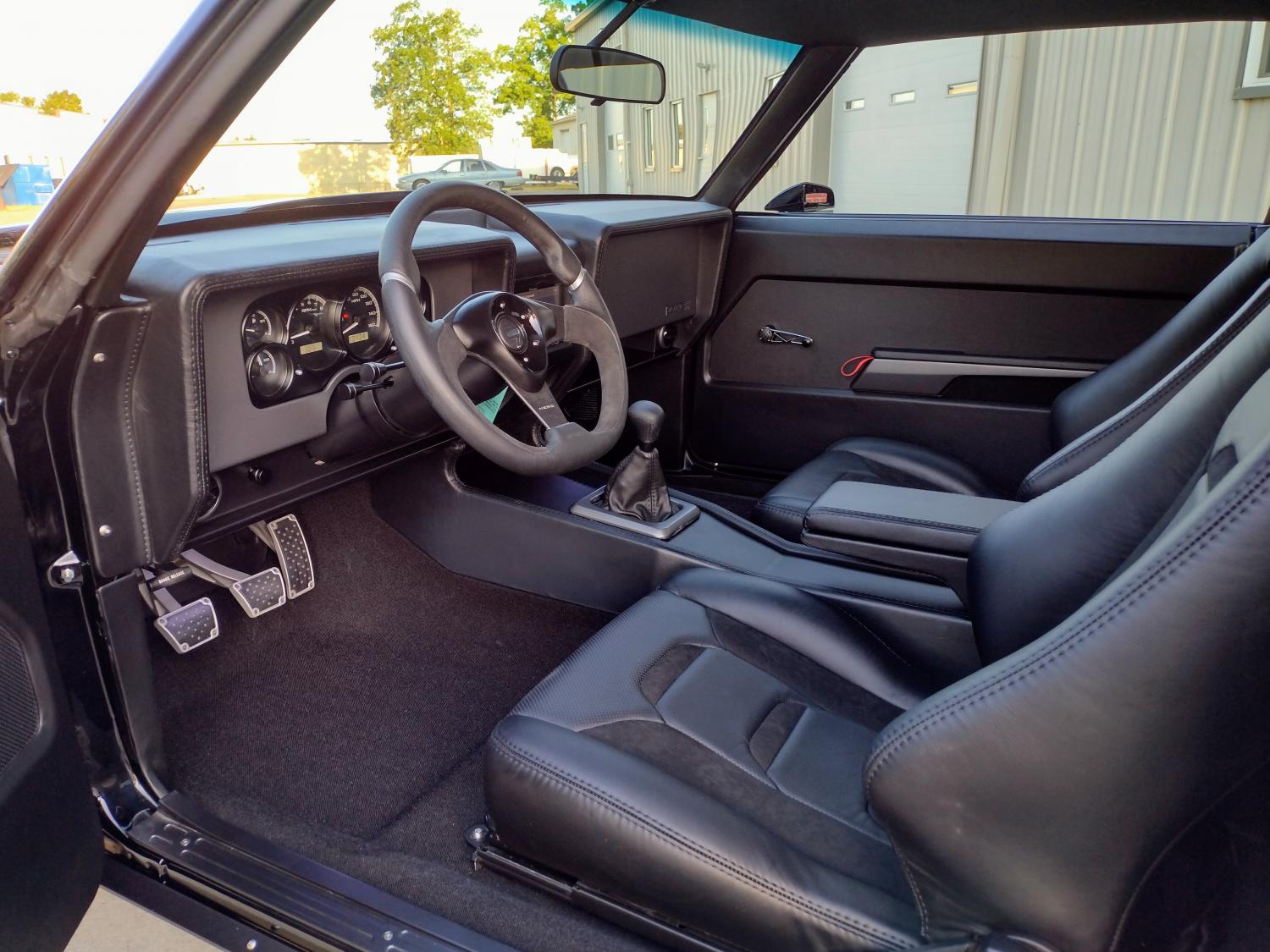

Default Jeff's '69 Camaro

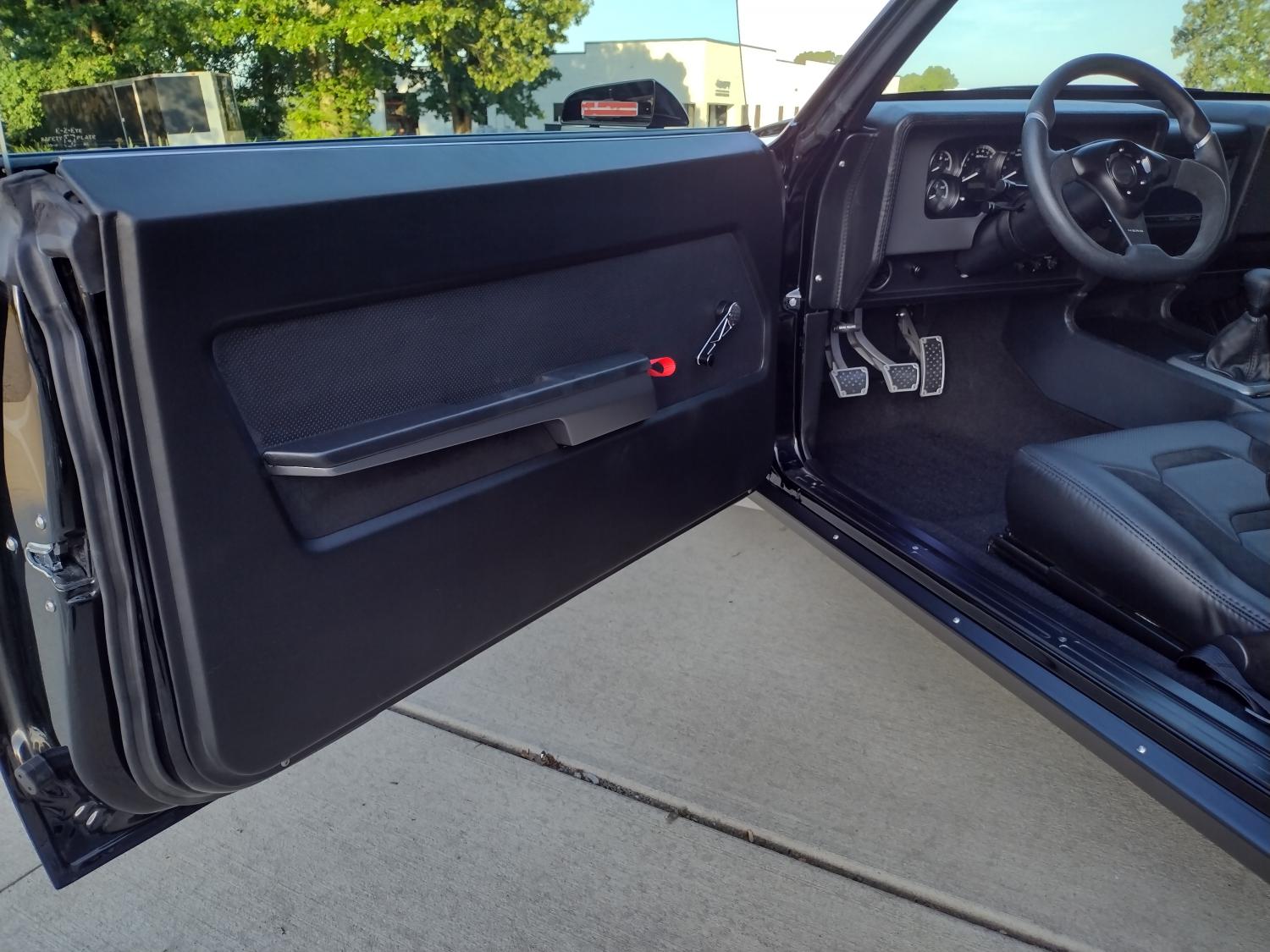

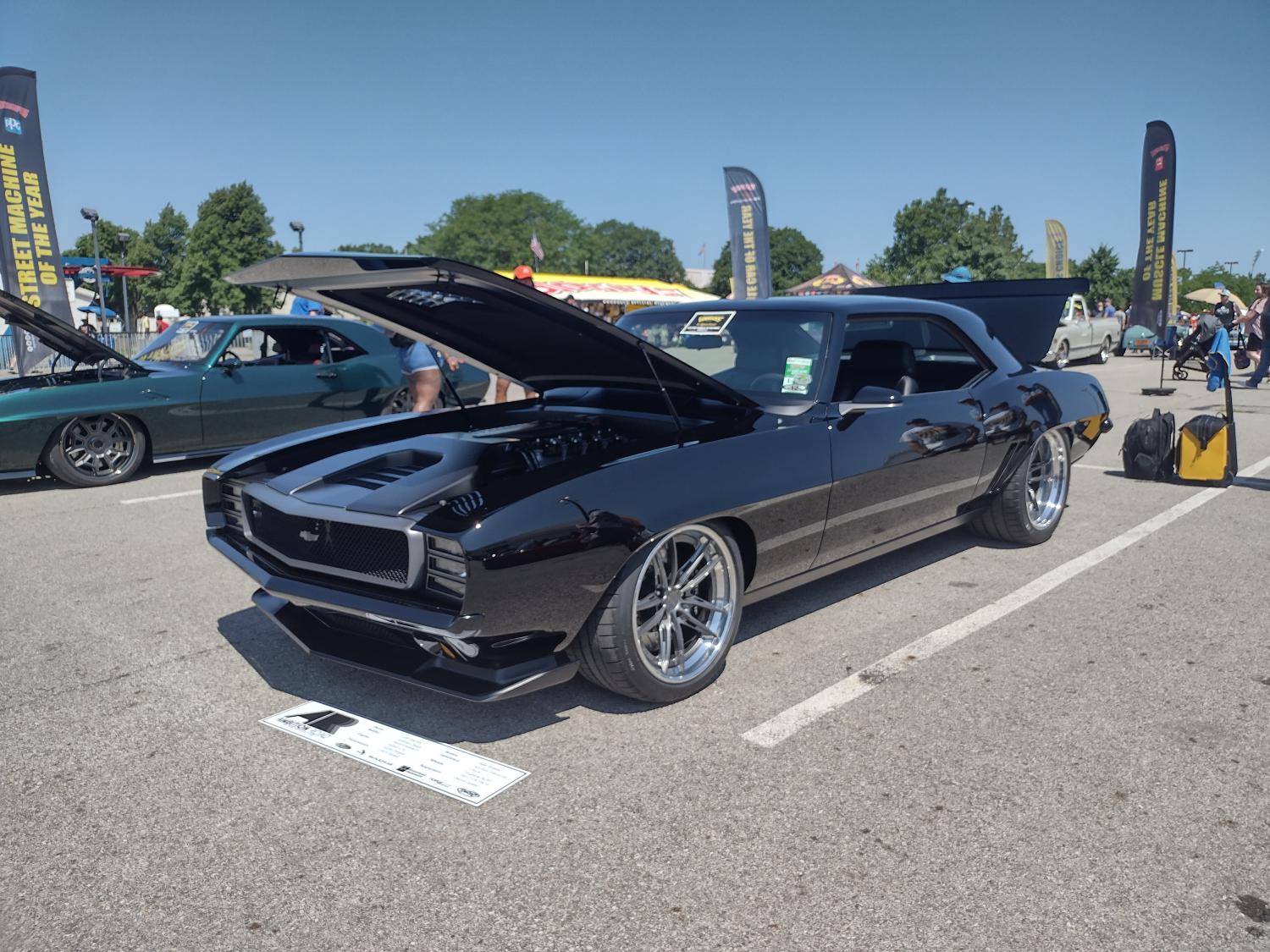

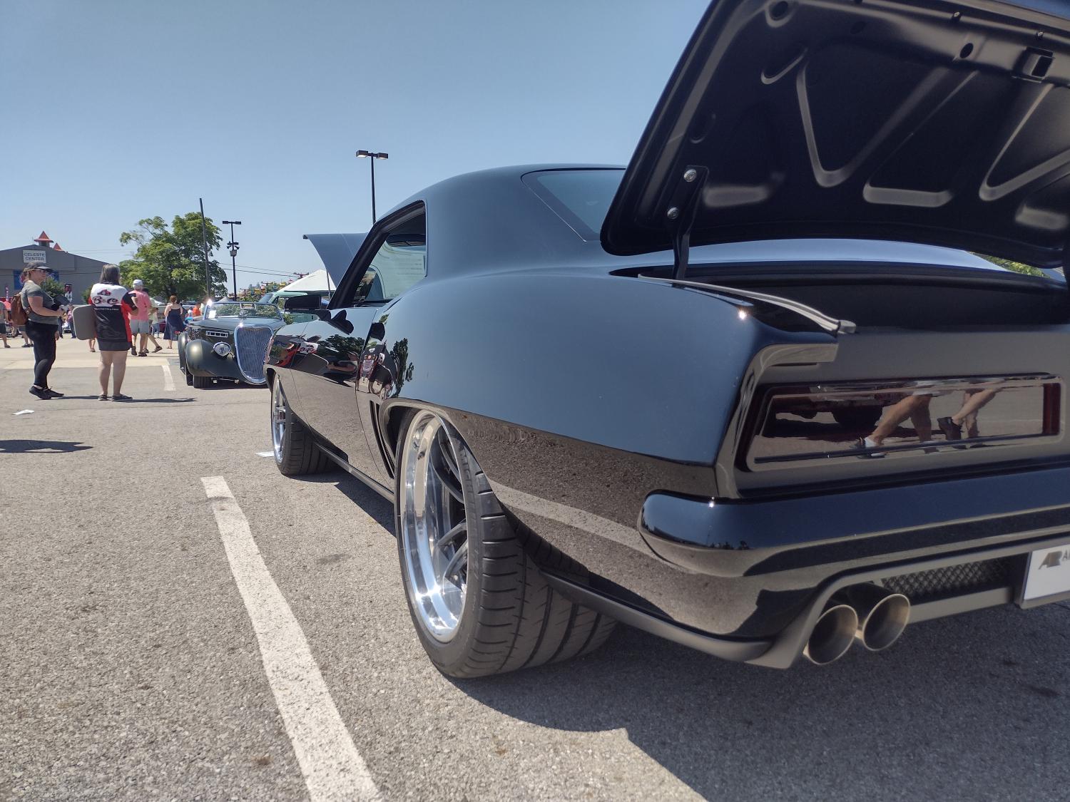

Hi everyone, just uploading some pics of Jeff's '69 Camaro we debuted at Goodguys Columbus this past weekend. We had about 3500 hours into it but stretched out over 7 years working with an annual budget. Thanks for everyone that came by to check it out and say hi. Some quick details:
GM crate 650hp LT4
T-56 6-speed trans
Detroit Speed subframe and Quadralink
GearFX GM 12 bolt rear
Forgeline AL307 19x12.5" and 18x10 wheels
Michelin pilot super sport 345/30-19 and 275/35-18
Glasurit single stage jet black, wet sanded then 6 coats of Glasurit 210 clear
Lots of custom fabrication
Fabricated interior upholstered by Hot Rod Interiors by Chuck

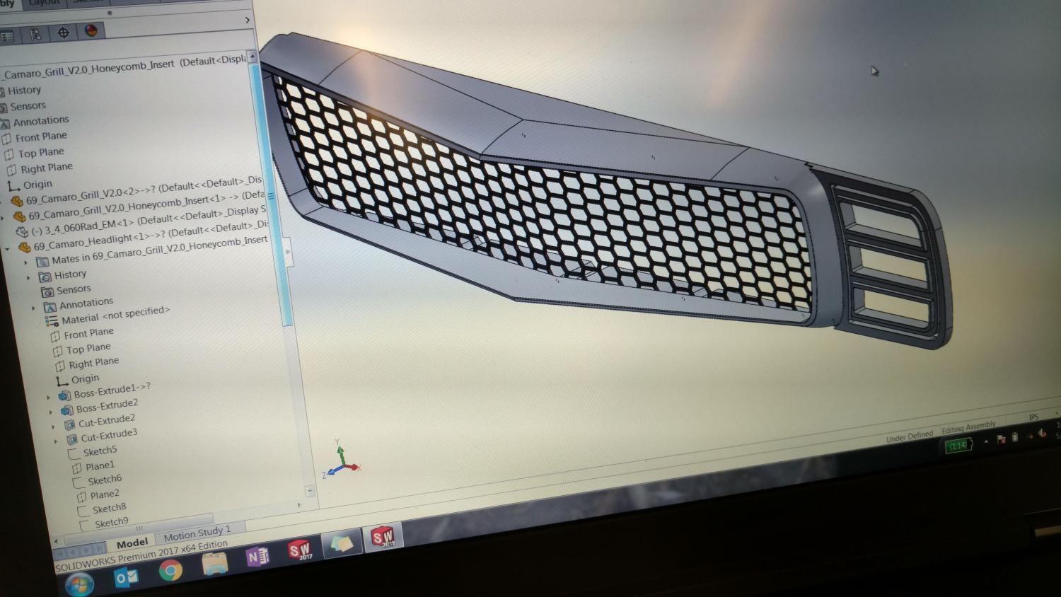

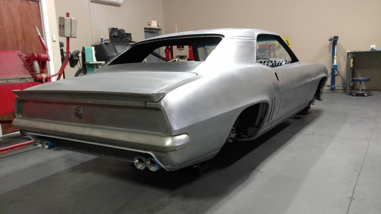

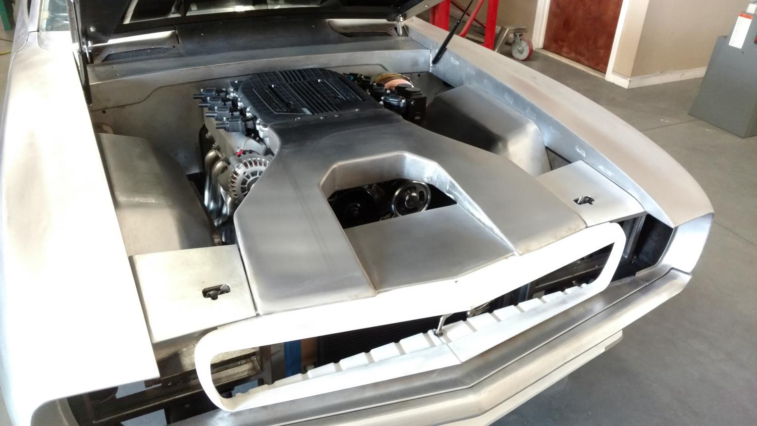

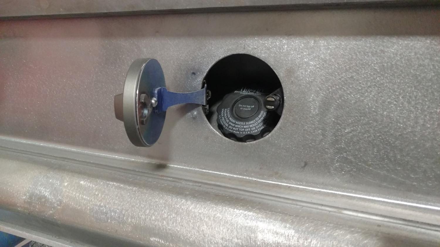

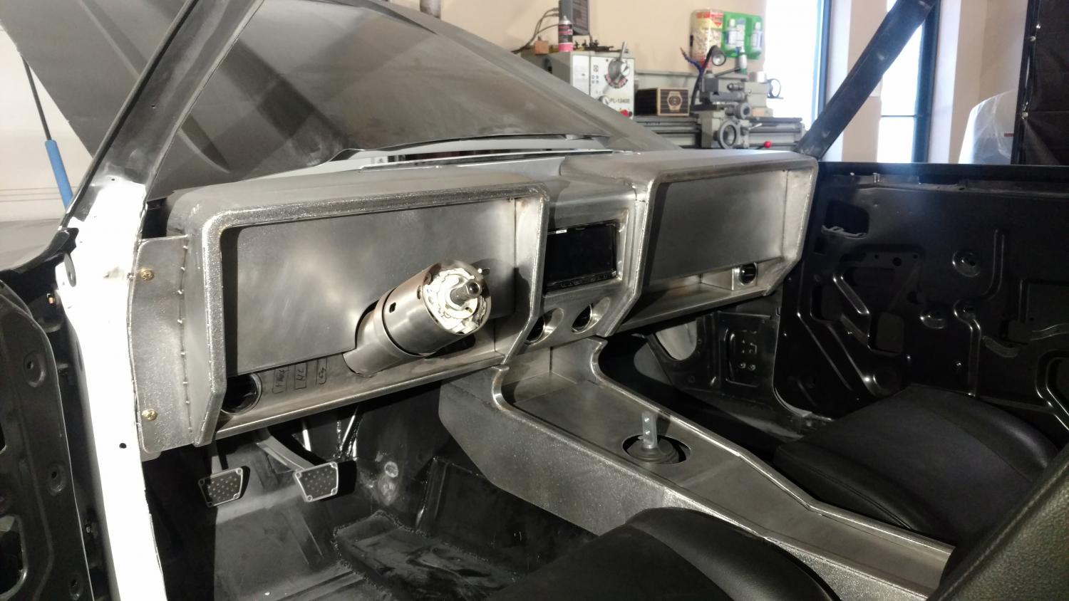

Default Metal fab photos
Metal fab photos

Thanks for sharing. Beautiful car. Top notch fab work. Are you guys painting your own rides yet or farming it out still?
The Following User Says Thank You to Jimbo1367 For This Useful Post:
Ambition Road (07-21-2022)
Old 07-16-2022, 04:10 PM
Ambition Road Ambition Road is offline
Join Date: Apr 2015
Location: Troutman, NC
Posts: 104
Thanks: 35
Thanked 68 Times in 14 Posts
Thanks. All in house now since moving into the bigger shop with our own paint booth.
