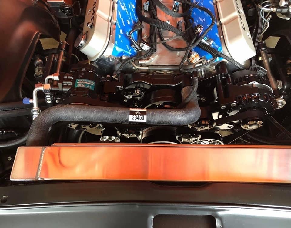

Hello need upper and lower radiator hose on this.
LSA engine with a C & R radiator ( part nr 10-00003)
This is on a 1969 Camaro.
Is it someoneon this forum know what to use ?
Maybye someone have a parts number on hose ?
Petter

[ATTACH]Name:  673CADEC-AE96-49EF-A264-563C4BDE4782.jpg
Size:  119.9 KB[/ATTACH]

A gates 23450 might help you with the upper with the drivers side outlet.

Two I've seen used on first gen swaps are Gates 22960 (upper) and 21618 and 21940 (lower). May have to trim one end or both for length.
