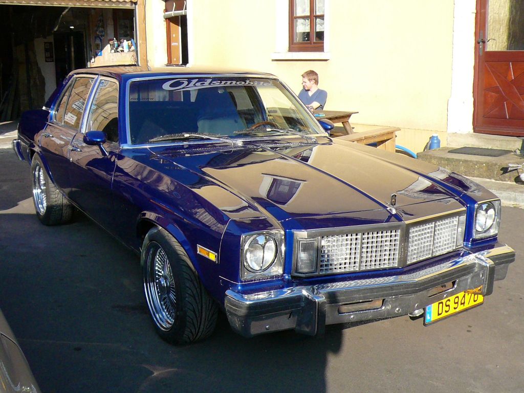

Old 08-31-2007, 10:01 AM
el-camino's Avatar
el-camino el-camino is offline
Location: S-73399 Möklinta Länsmansgården
Posts: 166
yesterday and today: colorsanding and buffing....i hate this job...but the result is great
greets from Sweden
Klaus
Old 09-02-2007, 02:30 PM
el-camino's Avatar
Posts: 166
greets from Sweden
Klaus
