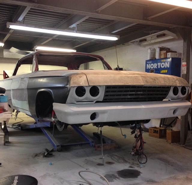

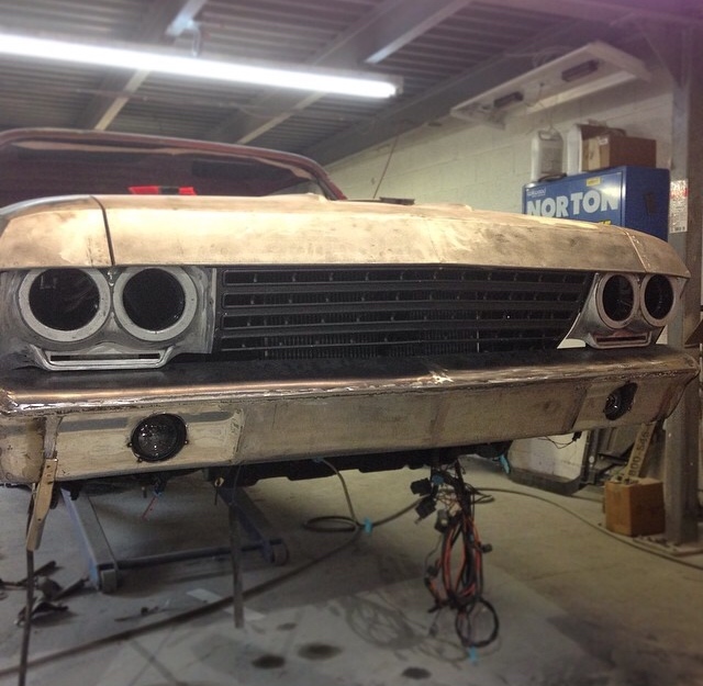

Hello everyone! Im currently working at Ross' Rods out of Fairfax Va and wanted to share with y'all some of the builds we have going on. A quick run down of the car is it has a warmed over 350 (until we go LS3 or bigger) Ridetech suspension with Accuair, JW speaker headlights, Billet Specialties wheels and a ton of body mods.

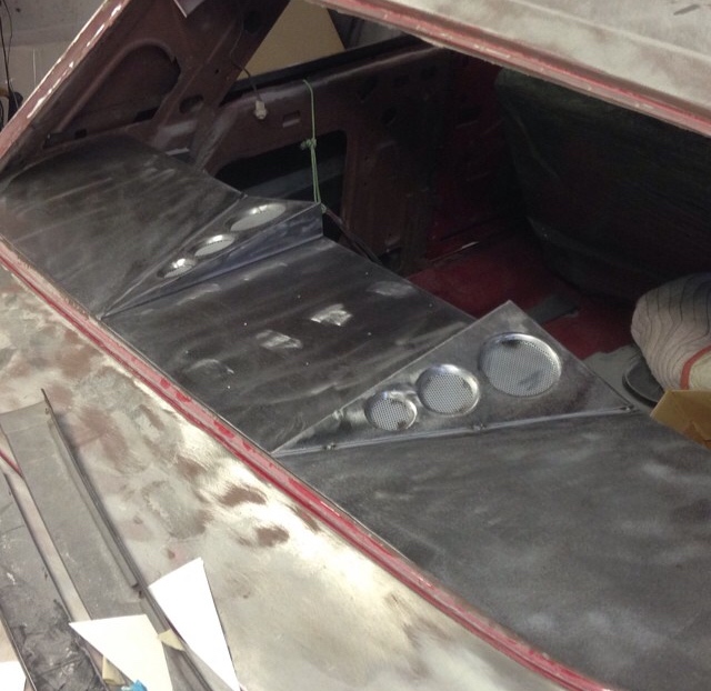

Currently I'm replacing the door skins and quarters due to the work that was done previously.

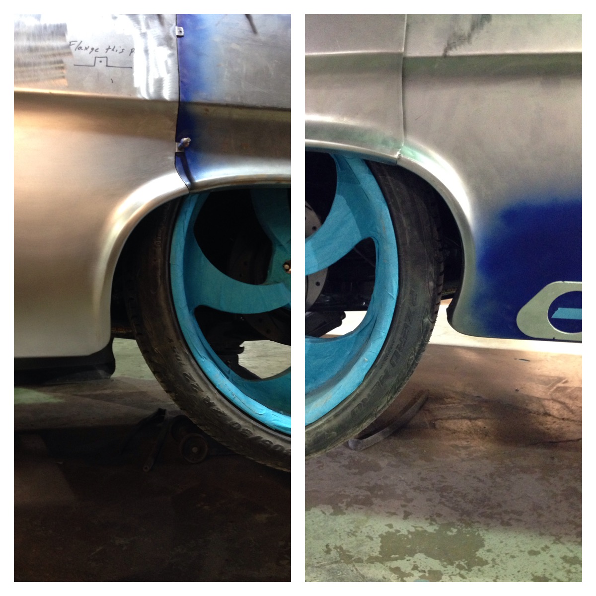

Re arched the front of the quarters to clear the wheels but brought the factory body line further down to look factory. Here's a side by side comparison of before and after

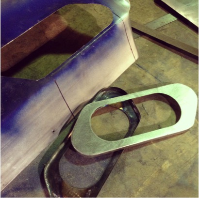

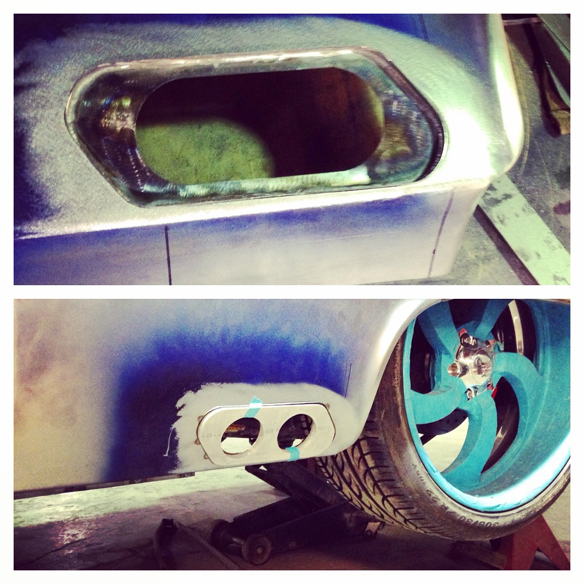

Next up was getting the exhaust bezel housing made up and welded in
The bezel has changed and ill get a pic of it later in the week once i cut it on my plasma table and countersink all the mounting holes
