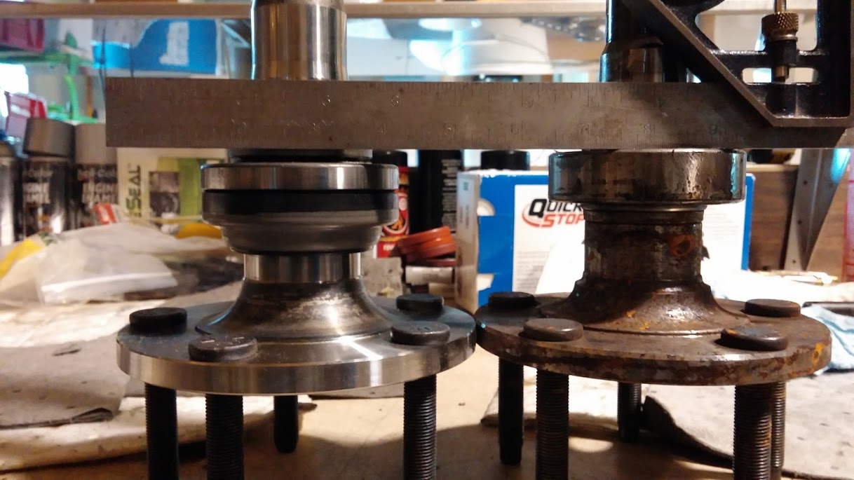

This is what I found when I compared the new and old driver side axles.
Basically the bearing is 20 thousands of an inch closer to the flange on the new one. That isn't that big of a deal in itself, it basically just moves the wheel in 20 thousands. The issue comes with reinstallation of the brake kit.

To my fuzzy eyecrometer, that looks like more than .020"
Honestly that looks like the difference between 2.50" axle offset and 2.36" axle offset.

I measured it a couple of different ways and it's pretty close to 20 thousands, maybe a few thousands either way but very close to the same thickness of the spacer ring.

Got the skinny, the difference is actually the axle flange thickness, the old one on the right is a 1/4" thick flange, new one on the left is a 3/8s" thick flange. Inside bearing race to outside axle flange measurement is the same on both axles. I'll verify this when I get home but it makes sense to me now that he mentioned it.

I noticed the flange thickness in the photo in your first post, and was hoping you had a follow-up shot with the wheel mounting surfaces lined up to see if that put the bearing in the same spot. In the picture I'm talking about, you can see the one on the left is off the same amount both ways.

That's just the way it is with this car (and many of our cars I believe). Things just need to be loved on every now and again to make thing splay nice together. I'm learning to not get as uptight about it as I used to get, just take it in stride and fix it.
Both axles have a 3/8s" flange,
The difference in length is this spacer between the bearing and end of the axle.
Lance, what is the distance between the straight edge and the inside of the bearing on the new axle in this picture? That is how much further inboard the axle face and consequently the rotor and wheel will be. I don't think you have the right axles.
