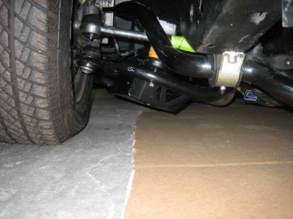

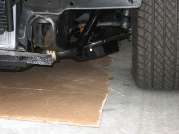

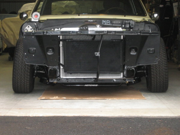

Took another look at things today, and took some pics. I think they speak for themselves that there is a problem here. Note the car is that low without any front sheetmetal. And almost 2" of spring spacers.

First pic shows distance from my swaybar to the ground - about 3.75" - obviously unacceptable. And that's with almost 2" of spacers on the front springs.
Second pic is of one of my other early GTOs - stock suspension, but also with a 1.25" front bar. That car has 10.5" of ground clearance at the front bar.
How could this front suspension possibly lower the car almost 10" over stock?

It looks to me like the springs are simply too short. Check the springs you have in it compared to the stock ones as far as free height. Then check the depth of the sping pocket in the LCA's. The depth from line from the center of the ball joint to the center of rotation. Then check the stock ones. I didn't realize at first, but this is the same front clip I used in my race cars. I had 5" ride height with stock LCA, 79 Impala spindles, long Howe Ball Joint and 27" Tires. If you are using dropped spindles, springs, and arms, I might see what you have from that. Anyway take some measurements.

Well, you really didn't get 10 full inches of drop... That swaybar has a U-offset in it between the mounting hangers, so it's an exaggerated reading. As the suspension tucks up into the wheel wells, the swaybar points down further.
***Still a ton of drop and definitely not right though

wow look at that LCA angle... deff not right...no you dont need air ride to fix it and (above post) even if he puts taller wheel on the the suspension geometry sux!... im a lil surprised marcus would reccomend those springs...i have seen many many unhappy purchasers of eibach springs for older cars... and have heard of people installing them and it doing what it did like yours and also seen they ride sky high!!! i have eibach in my 4th gen and love them though... like said above you just need taller springs.
