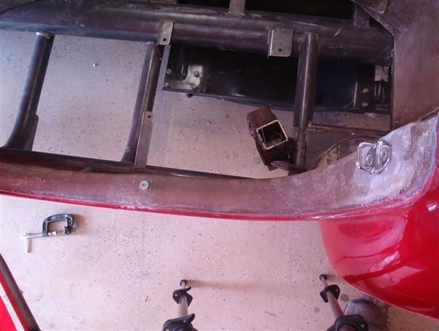

After spending all that time making panels for my car I didn't want to simply rivet them to the tubing. Not my style plus I didn't want all those holes in my chassis. So I spent an immense am out of time making little 1"x1" tabs with threaded holes to fix the panels to with screws. I haven't put the panels back on yet, but the tabs were tacked in place screwed to the panels so they do still fit,
there are over fifty of them welded to the back half of the chassis. I can't wait to do the rest of the chassis at least that will all be metal.

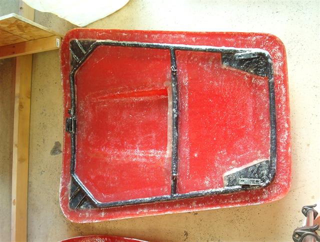

Da-am was that fun NOT, but hey they are done! Now I can't tell you how much filler and sanding these will take to finish but I have a base.
So here is the pics of the doors in full rough.
Now it's up to all of you lurkers to post up a comment;

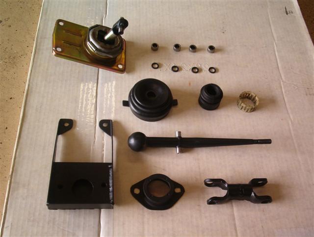

Well what I thought was going to be easy wasn't. Had to move the shifter forward about 5 inches, no problem just make a Z-bend shifter, YUK that sucked the movement was all wrong, how does someone ever get used to that. I couldn't so I did what I always do Go overboard and build some over engineered contraption to do the same job. With a bunch of junkyard parts and a fair amount of time I came up with this.
Pictures submitted for approval, some days I think I should be committed;

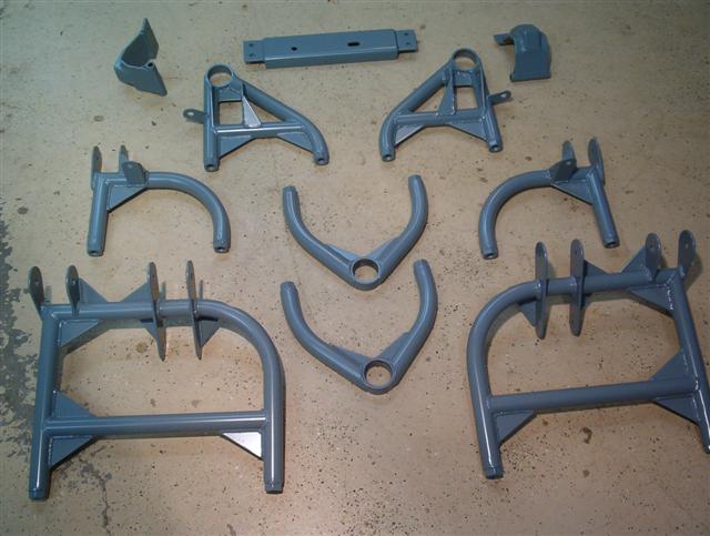

It's finally back from powder coat, the guy's at Extreme Powdercoating(www.extremepowdercoating.net) came through, other than being delayed by a very large job. Greg and Todd were very helpful and truly interested in doing a great job. Now here are the pics.
Well I guess I will have to start putting this thing together. Starting with aluminum for the floors and firewall, I'm thinking .050 should be thick enough for the job.

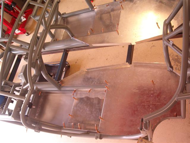

Hey just a quick update, I have started making aluminum panels for the car. Went out and got some .063 6061 sheet and went at it. Have made small steps so far. Here are my foot wells they were a lot more work than you would think.
that's it for now,

Hey, I have created a couple more pieces of aluminum this week. We now have floors. How do the look to you? I feel everybody has deserted me. There is hardly any traffic on the forum, so reply if you can. (that means all you lurkers out there)
I'll keep working on it but I like the feedback.
