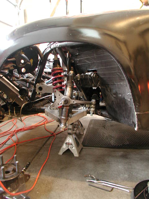

Took the car out to the track on 12/28/10 - there had been no snow until this last week tho' it was cold (49 deg). Max tire temps were about 120 deg on the fronts and 140 deg on the rears, so grip was minimized but I ended up turning one lap of 1:59.9 - fastest lap yet and only 1/2 second off the SCCA Super Production record at that track.
The guy with the record was there that day taking tire temps and helping me out He said he has already picked up 2 seconds on his tho' since the record set, we'll see. He has a V8 914 as well with a 650HP all aluminum 400 SBC (brodix block, dart heads, big solid roller cam).
Anyway, now that it snowed I got the car apart to redo the wheel bearings front and rear so here are shots of the suspension as promised. The rears I had the uprights out so I could press the bearings out, I will try to remember to put some shots of them reinstalled here in the next week (new bearings in transit)
The next to the last shot of just the rear hubs shows the spacer that Jim Patrick (Patrick Motorsports) makes to run late model Carrera hubs with a stock 914 bearing. There is one that goes on the stub axle as well when it is all bolted together.
