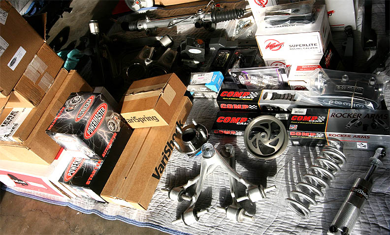

Most of the parts are in.. now I just have to put them on the car! lol
Gonna go check on the bodywork tomorrow and see how the firewall is progressing. I am also going to beef up where the fuel cell mounts.
Still waiting on the AFR heads, McLeod shifter, FAST intake and the wiring harness with the fly by wire pedal.. Oh, and the fuel tank by Ricks
So many parts to keep track of..

Wow. That's a nice little pile of toys. Now I'm jealous. Thanks.

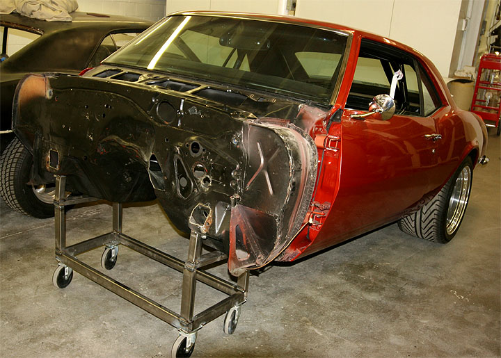

Well.. she isn't 2/3rds the car she used to be..
All the bumps have been cut off the firewall, looks like I am commited to running the fly by wire throttle body now since the factory gas pedal mount is GONE. A solid plate of steel is going to be welded over the factory firewall.

And to think you wasn't going to make this one "nice". Should be twice the car it was before.

Steve,
That car is just plain bad-ass
